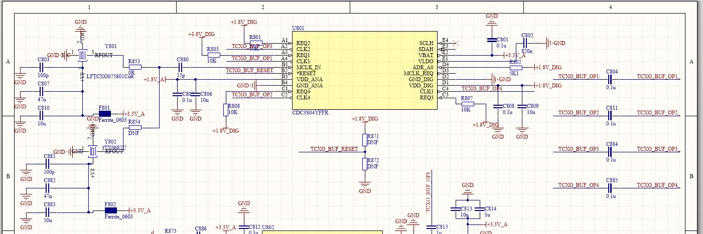

I'm using the CDC3S04YFFR to buffer a TCXO signal at 40 MHz (https://www.mouser.co.uk/datasheet/2/741/LFTCXO075801Cutt-1128696.pdf). I've measured the phase noise pre-buffer / post-buffer using a R&S FSW signal analyser and have found that it is being degraded by 10-16 dB for carrier offsets between 1 KHz and 1 MHz (see attached plot). However according to the datasheet the additive phase noise (specified at 38.4 MHz) is < -135 dBc/Hz across these offsets.
I've attached a screenshot of my schematic - I did try adding more decoupling caps (1 uF/10 uF) at VDD_ANA (pin B3) but made no difference. Do you have any other suggestions?
