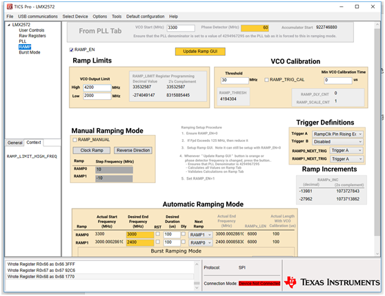

Dear TI Experts,
Now I am evaluating  LMX2572 ,~
I am using TISO PRO, when in automatic ramping mode,RAMP0  and RAMP1  cannot to be set under 3100MHz,otherwise it becomes orange`
I'd like to set he sweeping range from 2400  to 3000MHz,  RF reference input is 120MHz,Can you tell how to set this?Thank you very much~
  • Fawn,
    On TICSPro, you can mouse over any colored item and you should get a tooltip to explain why the colored alert is displayed.
    The VCO range is 3200 to 6400 MHz. But you can divide by 2 to get 1600 to 3200 MHz
    The frequencies in these boxes are the VCO frequency, NOT the true output frequency. In other words, if you want 2400 to 3000 MHz, then set up the device as it would be for 4800 to 6000 MHz and then use divide by 2 at the output.
