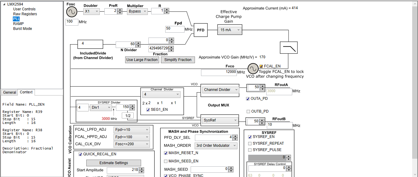

LMX2594: No SYSREF output on RFOUTBP
Part Number: LMX2594
I am not seeing any output when using SYSREF mode on RFOUTBP. I do see a notable difference in current being drawn from the power supply when OUTB_PD is unchecked or the SysREF output is not enabled, which seems to suggest that at least something is being driven internally, but I just do not see any output on an oscilloscope.
I believe I have set INPIN_IGNORE to low (unchecked in the GUI) and set the SysRefReq to high (checked in the GUI).

  • Garret,
    The things to remember are:
    1. INPIN_IGNORE=0
    2. SysRefReqPin is high
    I think you did this, but I see the phase interpolator frequency is 3000 MHz, which is out of range.  I note that you want to divide 12 GHz down to 10 MHz and if you put the SysRef divider to DIV2 instead of DIV1, then you don't get the divide you want, but this might be the issue.  You might try at least to get an output with the correct value for SysRef Divider.  You can also get 10 MHz using the proper divide like Fvco = 7680, CHDIV = 4, SYSREF_DIV_PRE= DIV2, SYSREF_DIV = 48, fOUTB=10 MHz
    Also ensure the proper signal level on this output and try toggling the CE pin and the INPIN_IGNORE bit to ensure they are updated..
    REgards,
    Dean
  • Dean,
    Not having f_interpolator in the correct range (.8 GHz - 1.5 GHz) is what I believe was causing the problem since I had f_interpolator at 3 GHz. I did notice that the output would still work to some degree for f_interpolator < .8 Ghz.
    Thanks again,
  • Garret,
    OK, great. I will assume this issue is resolved, unless you say otherwise.
    Dean
