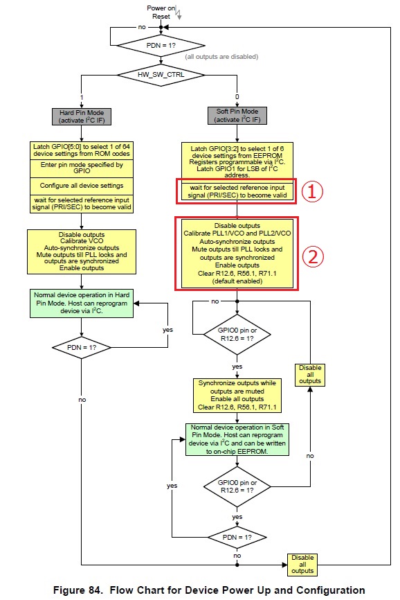

I have some question about Figure 84 in datasheet.
Q1 : About 1 below picture.
    Does this show device internal operation?
    What must we do anything? Please tell me more detail of this info.
    -> Should we confirm flag of Loss of Reference?
Q2 : About 2 below picture.
    What must we do anything? Please tell me more detail of setting info.
Kenji
  • Hi Kenji,
    They are internal operations. You just make sure there are correct voltage levels on HW-SW_CTRL & GPIO pins, LMK03328 can run in a correct path as you desired, and get reference valid for step "1". All descriptions in step "2" is automatic.
