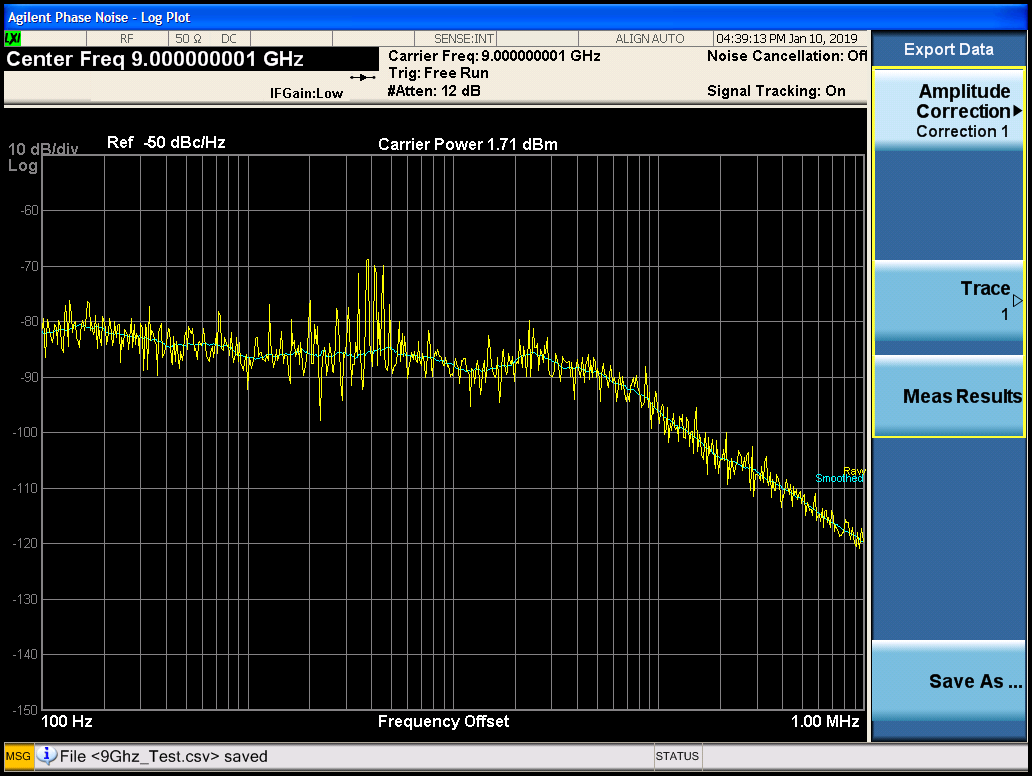

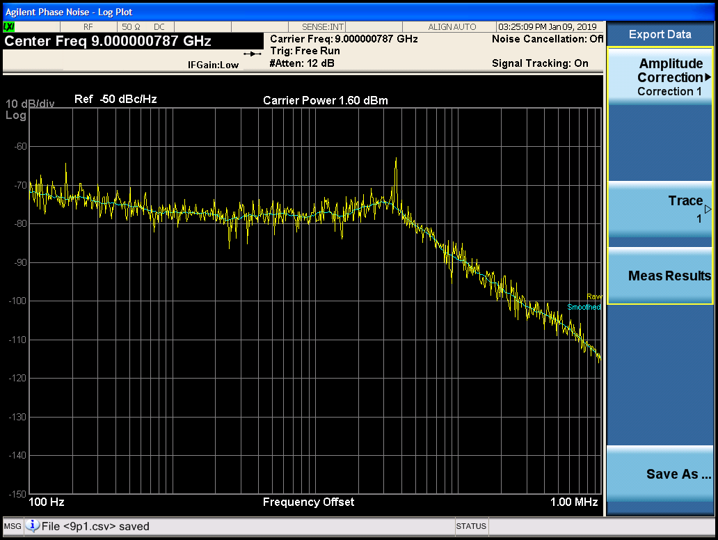

We are testing the LMX2595 with various signal sources and we are not seeing the phase noise profile being measured match what the data sheet specifies.
The data we measured along with the reference oscillator used are as follows:
1. 10MHz Sine Wave out of our ESA with phase noise and results:
2. 5MHz CMOS Clock with phase noise and results
While we were not expecting the phase noise performance itself to match the data sheet exactly we were expecting the same type of shape and general performance. If anyone is able to shed some light on what is going on and/or how to potentially solve the issue it would be greatly appreciated.

  • As some added information we are using the EVM board configured to accept external reference clocks with the loop filter remaining the same. We were expecting something similar to the expected results in the data sheet for the EVM, especially as we are using two oscillators with higher specifications than the original oscillator on the board.

  • Kyle,
    I looked at the original plots and think it's the signal generator.
    Your input reference claims -131 dBc/Hz at 100 KHz offset for a 1 GHz carrier. This works out to about -112 dBc/Hz at 100 kHz for just this. So maybe you are thinking it is sufficient, but that's a bad assumption.
    In general, signal generators get better normalized noise at higher frequencies. There is a theoretical reason for this.
    So what I am saying is that since you are using this at 10 MHz, not 1 GHz, you can't use the 1 GHz specifications; they are way off.
    A good experiment with signal generators and PLL noise is to keep the phase detector frequency constant, but increase the input reference frequency.
    In other words, if you keep the same output frequency (9 GHz) and use a phase detector frequency of 100 MHz, you will find that if I take 1000 MHz from the signal generator and divide it by 10 to get 100 MHz phase detector, I will get better phase noise at the LMX2594 output than simply taking 100 MHz input straight to the phase detector.
    Dean
