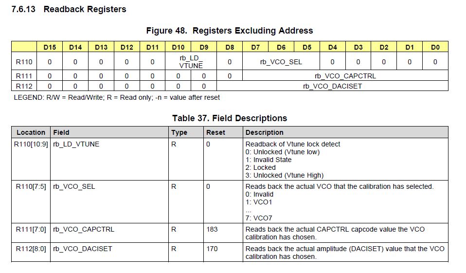

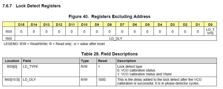

I have read the LMX2594 data sheet and found the register R60 that can readback the lock time delay.
I read back R110 and the status is locked, but R60 value is 0.
If I set LD_DLY to 100 and read back is 100, Is my setting wrong or something missed?
How can I read back the PLL lock time from register without set LD_DLY Manual?

  • Hi Scott,
    LD_DLY is not a measure of the PLL lock time. It is a delay time that we can add between VCO calibration done and MUXout pin turns HIGH.
    There is no way that we can readback the PLL lock time from registers. The lock time has to be measured with a scope on the MUXout pin or more accurately, with a RF signal analyzer.
