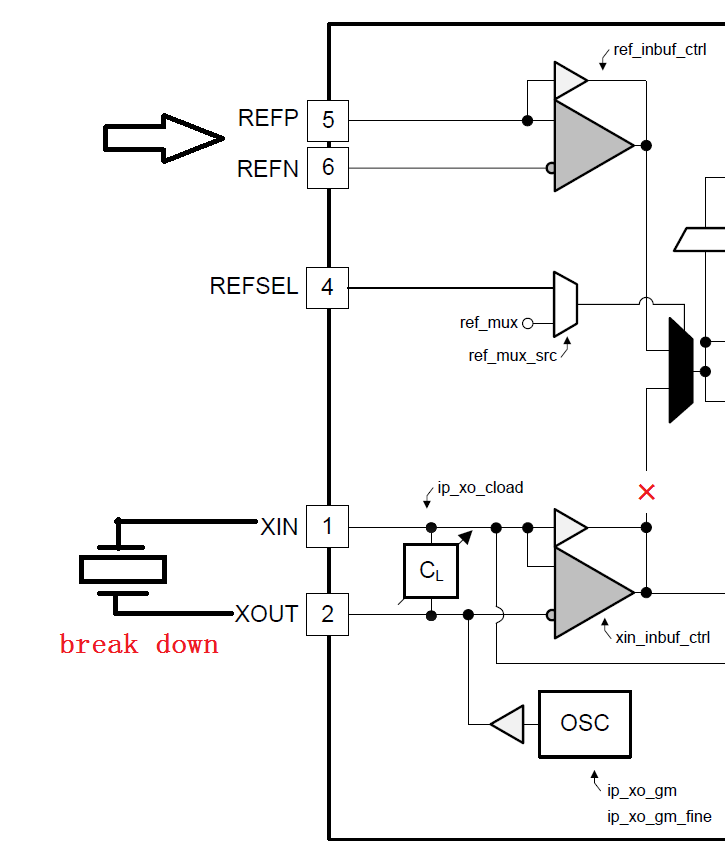

i have question of Clock Source selecting ( REFSEL pin ).
when i select LVCOMS to Clock Source,Crystal Oscillator was break down...
Is there any to make Crystal Oscillator work properly?
Thx.
  • I think that's not a break-down, that's power down oscillation circuits for XIN & XOUT when you select REFP & REFN.
    When you select XIN & XOUT with REFSEL= Low, the oscillator should work.
    REFSEL is used to select between the input references to the PLL. A low level selects the crystal reference on
    XIN. A high level selects the differential input reference on REFP, REFN.
