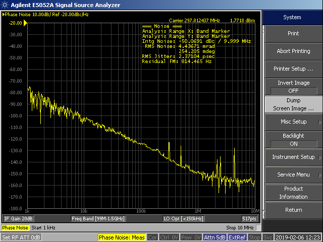

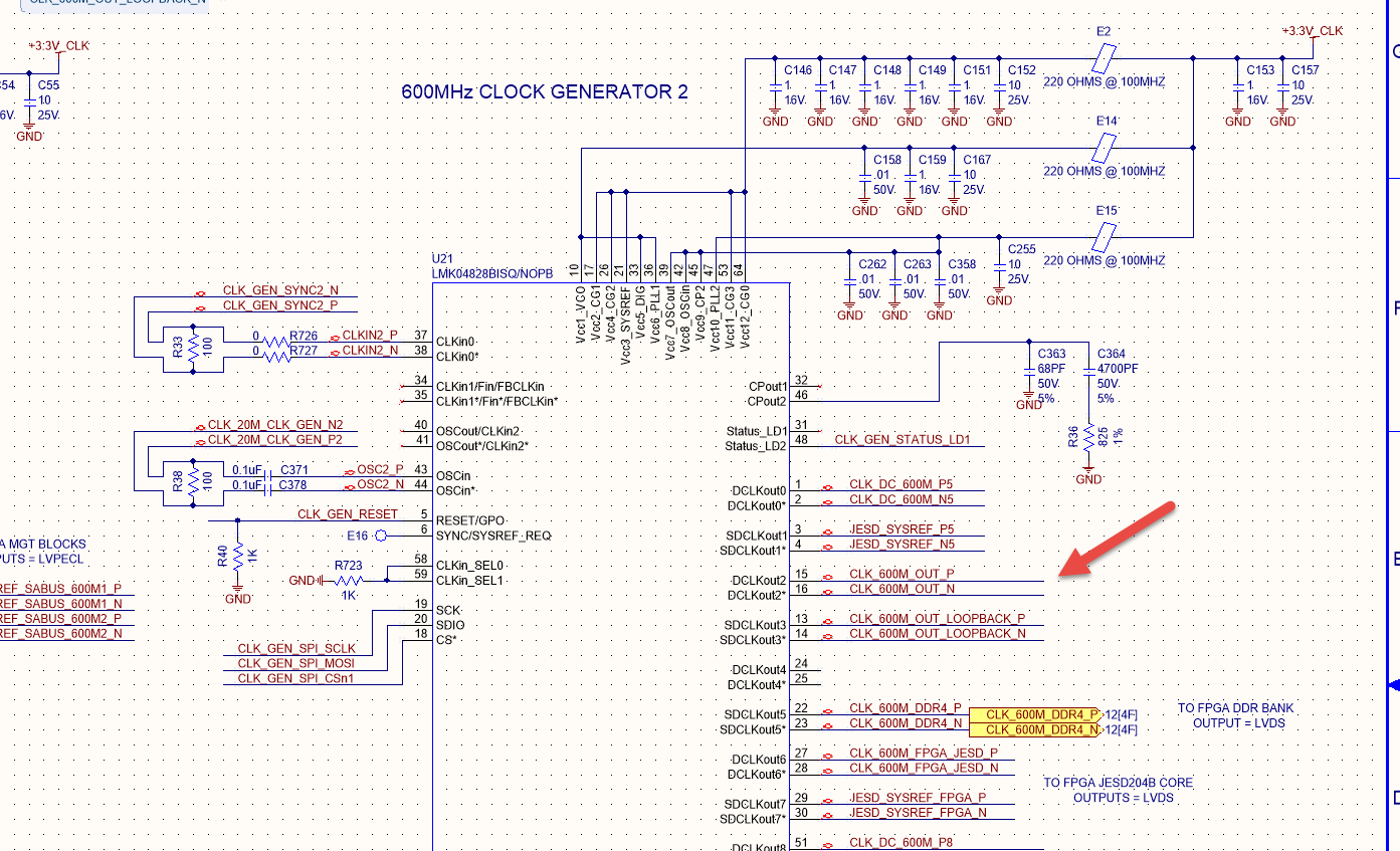

We have a board with two FPGAs and four LMK04828s. Each FPGA programs two of the LMK04828s. However, each of the four LMK04828s share the same oscillator reference which is fanned out using a low jitter LVDS buffer. The two LMK04828s programmed by the first FPGA appear to have acceptable phase noise performance compared to the baseline taken using the evaluation board. However, the other two LMK04828s connected to the second FPGA have terrible phase noise under 100k offset and the charge pump output pin appears to have a sawtooth-like waveform. The first two LMK04828s are identical in schematic design to the second set of LMK04828s and their layouts are very similar, but not 100% the same. I do not understand what could possibly be going on with the second set connected to FPGA 2. They are like this on all boards so its not just a one-off issue. I am including screenshots of the eval board basline which has about 287fs of jitter, an output of one of the second LMK04828 on the first FPGA & its CPout value, and an output of the second LMK04828 on the second FPGA & its CPout value. Also included screenshots of part of the schematic showing the output used to connect to the E5052A. This output has 240 ohm bias resistors since the output is LVPECL. Also shown is a schematic showing the clock reference and fanout buffer.

    We are using a single loop 0-delay setup so PLL1 is powered down. We are only using PLL2 and we are feeding our reference into OSCin pins as shown in the schematic image I included in the post. So in this case, does what you saying still apply to PLL2? I will try what you are suggesting with register 0x168.

  • if we write 0x0F into 0x168 nothing happens. At least nothing we can detect on the signal source analyzer. If we write 0x00 to 0x168 we get a different profile (shown below), however the output clock is about 297MHz and PLL2 is not locked. If we then write 0x0F back to 0x168 at this point, the PLL locks and the phase noise plot goes back to looking all distorted again. We noticed DAC LOCKED register is always low - but do not know what this means. I also probed all of the voltage pins on the IC and did not see a difference between the two LMKs that work and the two that do not. The only difference seen on the pins is the jitter on the clock outputs and the the CPout behavior. What could the issue be? If the thermal pad was not soldered down properly could this be the case? Or noise coupled into a particular pin?

    Is the hardware, specifically the loop filter the same for both the locking and not locking cases? For the case it does not lock, it does look like maybe the VCO is choosing the correct frequency band, but perhaps there is some sort of instability. Also, this can happen if you accidentally swap the loop filter capacitors in the loop filter.
    Dean

    The charge pump sawtooth looks as if there is some large leakage pulling the charge pump high or low.  If you tri-state the PLL2 charge pump, are you able to confirm this net is high impedance or if there is some impedance pulling to ground or Vcc?  For this test, set PLL2_CP_TRI = 1.  This is located in register R361, bit 1.
    * Granted, your schematic looks legit for your PLL2 loop filter.
    What is the frequency of your PLL2 phase detector?  Looking at the charge pump waveform, it seems the period is about 570 us resulting in ~1754 Hz PDF rate?
    It seems both plots you shared, the good and the bad both have spurs at this ~1.7 kHz frequency... although I don't see that in the EVM case.  In the 'good' case the spurs are small.  In the 'bad' case the spurs are totally destroying your phase noise.
