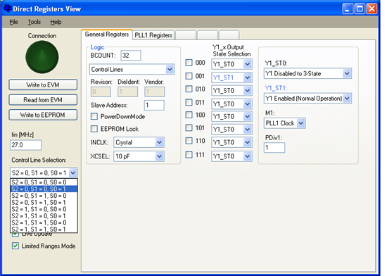

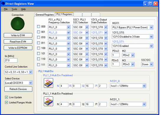

    Another problem, can I write 8 different setups for 8 output selection into the EEPROM at the same time?
    I'm going to use external control pins to select 8 different output and how should I save the predefined values to EEPROM?
    Look forward to your answer. Thank you!
  • I would suggest you to write first the configuration you would like to have first.
    You can generate easily the configuration by using the followign software:
    http://www.ti.com/litv/zip/scac119b
    When executed, skip the wizard and go the main window. In the menu bar, select Tools>Direct register view
    Please note that in the control line selection combo is the control pins configuration and will set to blue the active setup for that selection. i.e. in this case when selecting S2=0, S1=0, S0=1, that will make active the Y1_ST1 selection that looking at Y1_ST1 combo box implies Y1 enabled. Also the PLL settings selected are the ones of PLL1_0 settings, as well as the SSC:off and Y2Y3 output stage definition is equal to the one defined in Y2Y3_ST1 that looking at its combo box selection is Y2/Y3 enabled.
    Once your setup in written then you need to configure the device so S0, S1 and S2 work as control pins, in order to achieve that:  the SPICON bit (bit 6 on byte 2) needs to be set to 1, and then that stored to the EEPROM by writing (1 in bit 0 of byte 6) .
    After writing the SPICON bit and saving that into the EEPROM. I2C communication would be possible when Vddout=GND and the two last bits of the slave address are set to 00. In this mode it is possible setting SPICON back to 0 when saved into the EEPROM (write 1 in bit 0 of byte 6). After this writting  I2C communication can be carried out as normal.
