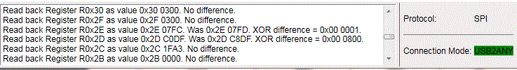

    I do not have a routine for readback yet. Is it possible to read back the registers with Ticspro? I would set a frequency with my controller and read back with Ticspro afterwards. I dont think so because of following steps:

    5. read back the register i changed in step 3
    6. Ticspro console window always says there is "no difference" and "read as value". This value is in the programm currently (which can see it in "Raw Registers", set with step 3), but actually it can not be in the register of the LMX?
    Also Ticspro console window tells me the same if click on "Read" or "Read Register" and even USB2ANY is not connected to the board.

  • Hi Marcus,
    Yes I agree that it is confusing that Ticspro reads back things even when it's not connected. However, if it is connected to a valid device, it does read back useful information.
    For example, I did exactly what you said. I get the PLL to lock at 7GHz, unplug the ribbon header from LMX2594, change the frequency to 8G, connect the ribbon back and readback. There are different values:
    Make sure that the connection is good when you readback, otherwise it reads back the same things.

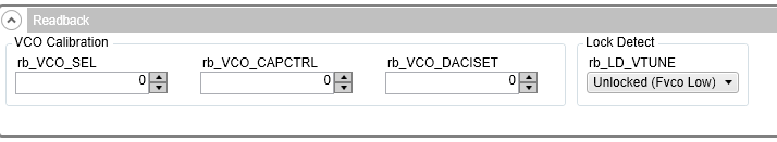

    When reading back, pay attention to these registers, as they give information of whether the device is locked and how it is locked. For details of these registers, please refer to the datasheet.
    After you're able to read back registers, try comparing the readback registers when the frequency switching is successful and unsuccessful, and see if you can find any clue.

  • Hi Hao,
    i managed to do a readback with Ticspro and cloud see that some registers have wrong values. But it seems like i finally could solve the problem by using the voltage supply from my controller (Raspi) and not a external voltage supply! Just now it set many many frequencies successful and zero unsuccessful. Many thanks for your help!
