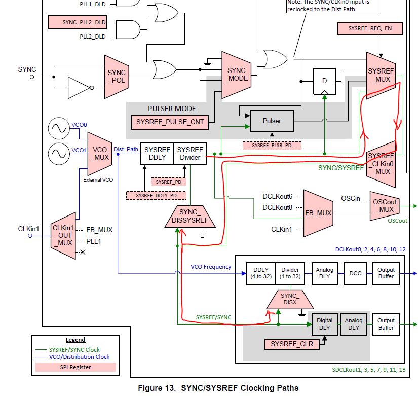

LMK04828BEVM: lmk04828b sysref frequency not changing
Part Number: LMK04828BEVM
Other Parts Discussed in Thread: LMK04821, LMK04828
We are using LMK04828B in one of our enodeb design with jesd204b interface.
LMK is used to generate the devclk and sysref. Pls find attached the

values.
The issue is we are not getting the Sysref frequency of 360khz . the devclk is 122.88mhz. We are getting 122.88mhz continuosly in sysref also.
The sysref settings are not changing the frequency.
Kindly let me know the settings for sysref os 120khz ot 360khz square, or pulse.
Kindly help.
