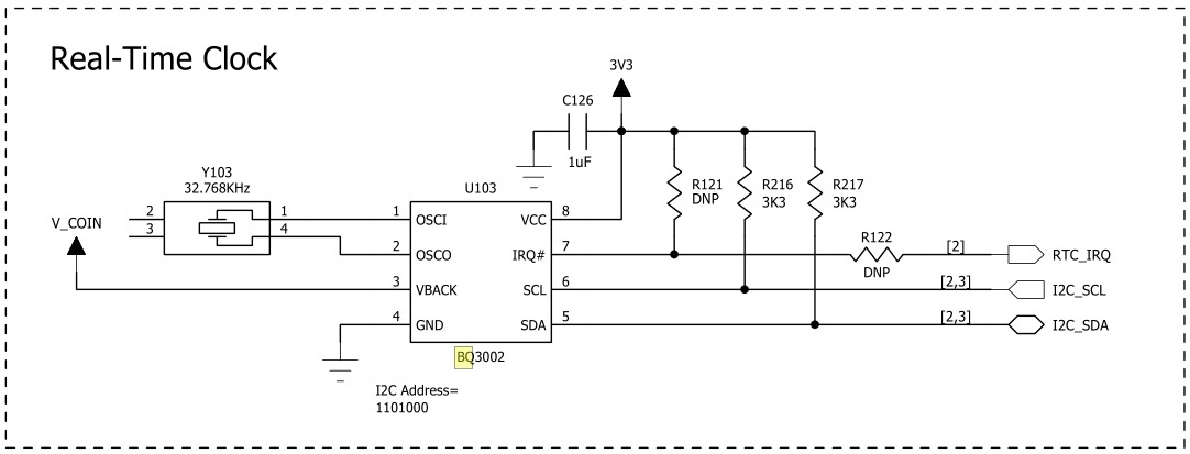

  • Hi Rob,
        Yes, we do have multiple boards because it's under pre-production state. We temporarily disable the STOP oscillator feature because it's low power consumption even keeping running.
      Here is the schematic of RTC part,
    Can help check if anything wrong from the design ?  Thanks for your support.
  • Hi Daniel,
    I don't see an issue with your schematic.  I am trying to get access to more internal documentation to help you and I am having a difficult time.  I will have an update for you by the middle of next week.
  • Hi daniel,
    I have received our internal documentation and I do not see a problem or correction for your OF flag issue. I also don't see a history of OF flag bugs in the device.
