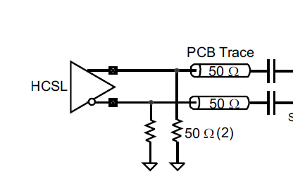

Do you have any example of HCSL input circuit with LMK00105.
Input: XUN536100.000000I (IDT)
Should I insert 50Ω pull-down like below?
ttd
  • Hello ttd,
    I would place series resistors close to the HCSL output for source matching if necessary - start with 0 ohm, then transmission line, then the 50 ohms to ground, series caps to LMK00105 input.
    - This allows the 50 ohms which provide the bias for the transmitter to also serve as the RF termination. Set the LMK00105 for external termination.
