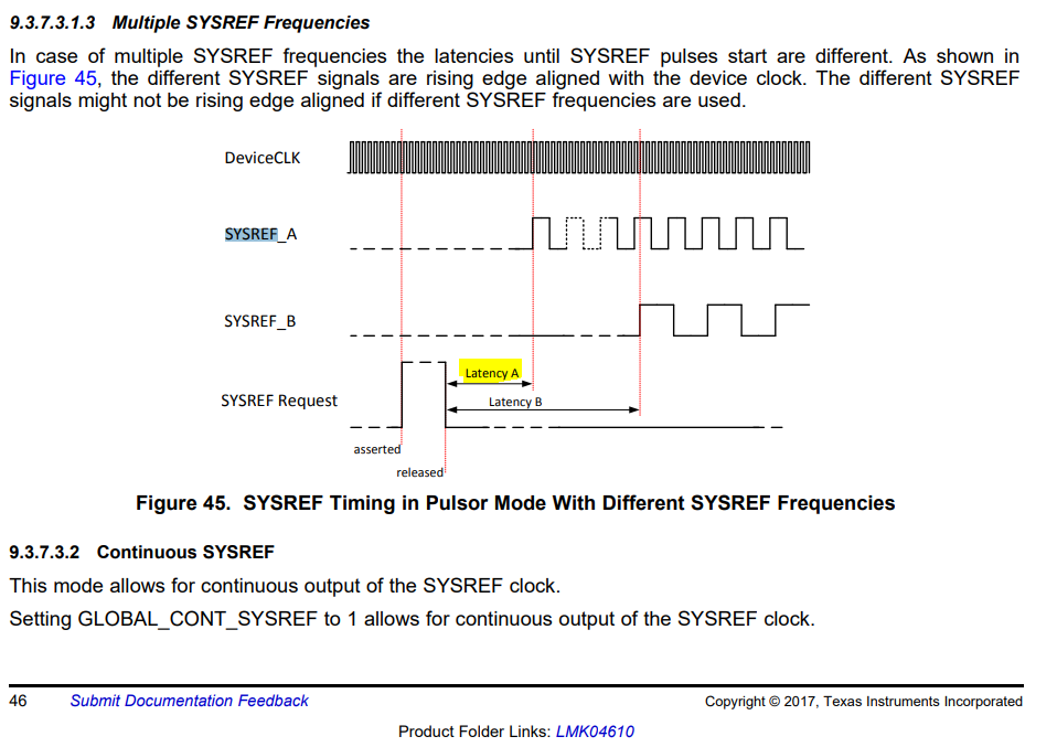

    Here is what we are trying to do:
    We are planning a system of multiple JESD204B DACs and ADCs and LMK04610 device that will by synchronized to much slower but irregular in frequency event. Think of it as once in a while at a random time the system will get a synchronicity trigger (synchronous to the incoming clock to LMK04610 device). It is the nature of our system such that we need deterministic and repeatable latency from that trigger event to the SYSREF output to all the devices.
    In retrospect I think it will be more useful to us to use SYNC pin as clock sync upon startup only and then reconfigure it as a SYSREF issuer.
    Follow up question:
    If SYNC is reconfigured as a pulsed SYSREF issuer with number of pulses being issued 1 and 0 digital delay, what is the practical delay between assertion/release of SYNC and SYSREF being issued?
    Incoming clock is 125Mhz, outgoing clock 750Mhz, SYSREF outgoing frequency is set to 7.8125Mhz.
    See image below.

  • Timothy,
    Thank you for your help. I was hoping this was an undocumented or overlooked in the datasheet explanation. In general what is the minimum latency between getting SYSREF request and actual SYSREF pulses coming out? And how is it varied between devices? I seek understanding on how device works with aspect to SYSREF. The particular example that I have given you is just an example. I place the least priority on the specific answer for it. But in general we have a week or so to before we have to know the answer on how SYSREF works.
