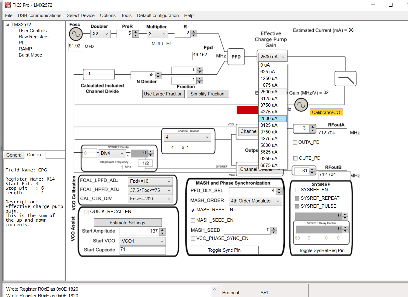

LMX2572: TICS Pro Charge Pump gain inconsistency
Part Number: LMX2572

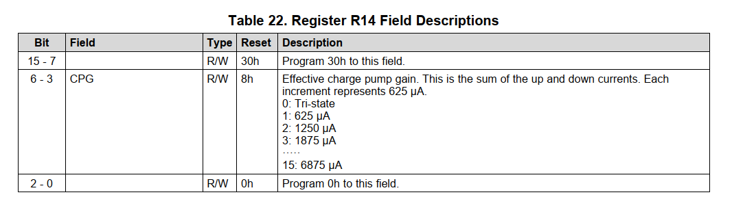

Datasheet and TICSPro inconstistency once more. Minor issue but should be fixed.
This table (22) is not consistent with table (2) of the datasheet:
Worse yet - if I set my device to CPG = 8 (that is 2500) it does not lock/work, if I set it to CPG = 4 (that is 2500 again) it DOES lock. What is going on here?
