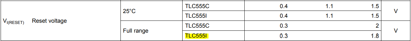

Customer is trying to reset the TLC555 using a logic device.
Could you tell me the required time to reset the TLC555I.
Please tell me to time add the High to the RESET pin.

    There is no timing guidance in the data sheet. I suggest a minimum of 2 us low time to reset the TLC555. I checked a sample device and the minimum time was 340ns (2V to 15V supply). 2 us should be more than sufficient to allow for temperature and sample to sample variance
    The reset low voltage (VIL) should be less than 0.3V and rest high voltage (VIH) should be greater than 2V
