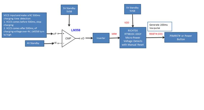

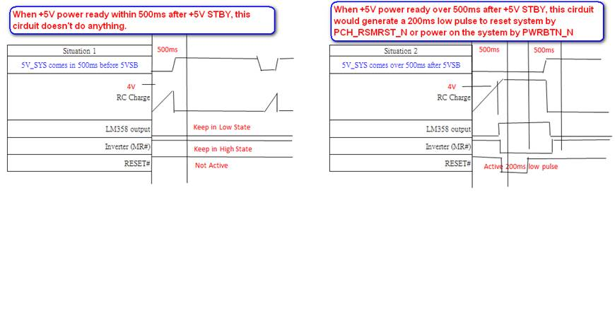

Hello
      Could LM555 support below application? Thank you.
BR
Patrick
  • Patrick,
    Do you want 555 timer to perform the 500ms check timer and the 200ms reset pulse timer functions?
    For the 200ms reset timer, couple the reset input through a capacitor because 555 trigger input is level sensitive. The 555 output will be high for 200ms so it needs to be inverted for a low pulse.
