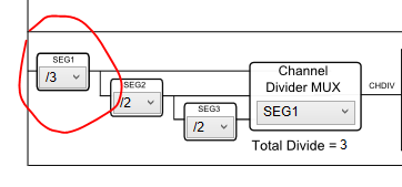

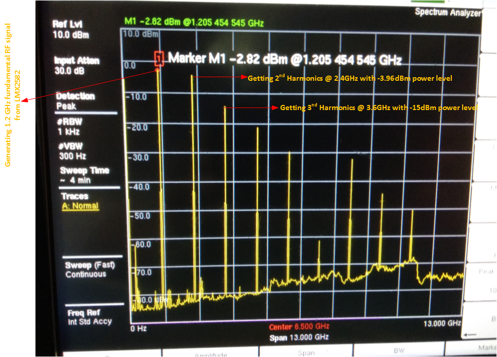

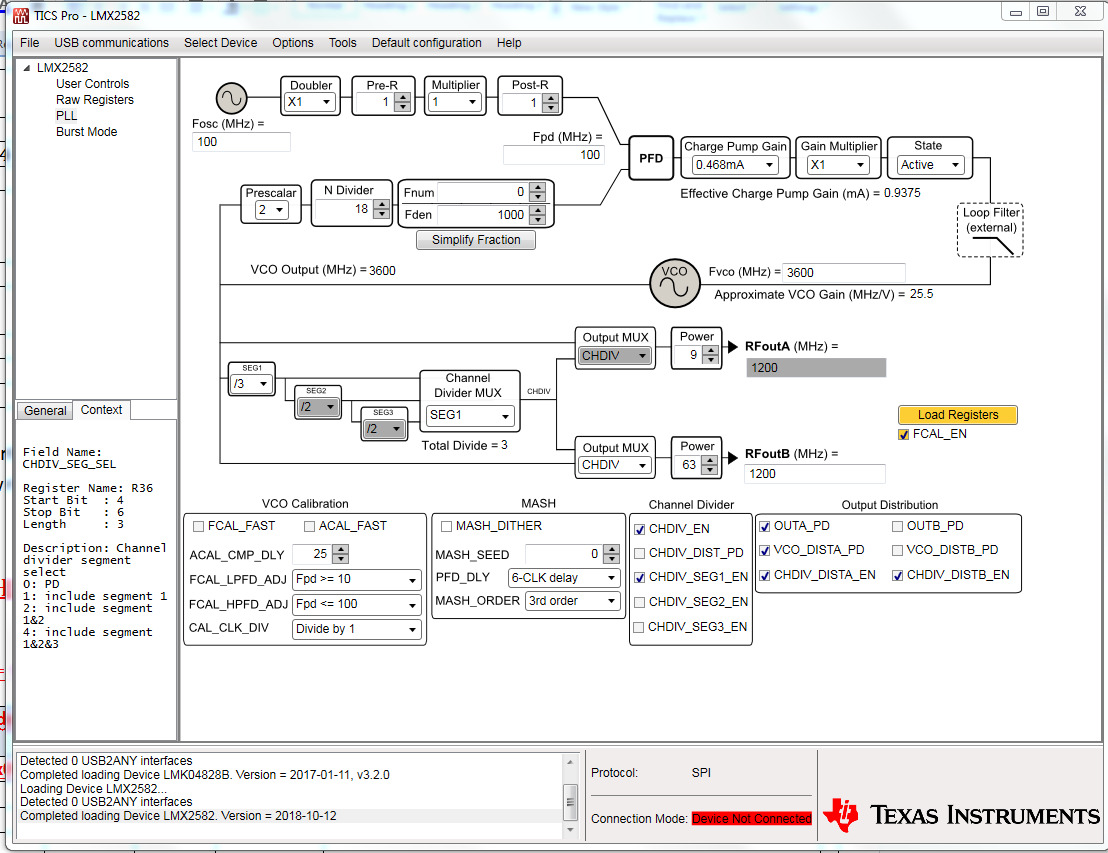

I am using LMX2582 for generating RF output from 950MHz to 1450MHz.
But we are getting lot of harmonics which are not suppressed as per mentioned in datasheet ie -27dBc for 2nd harmonics & -25dBc for 3rd Harmonic.

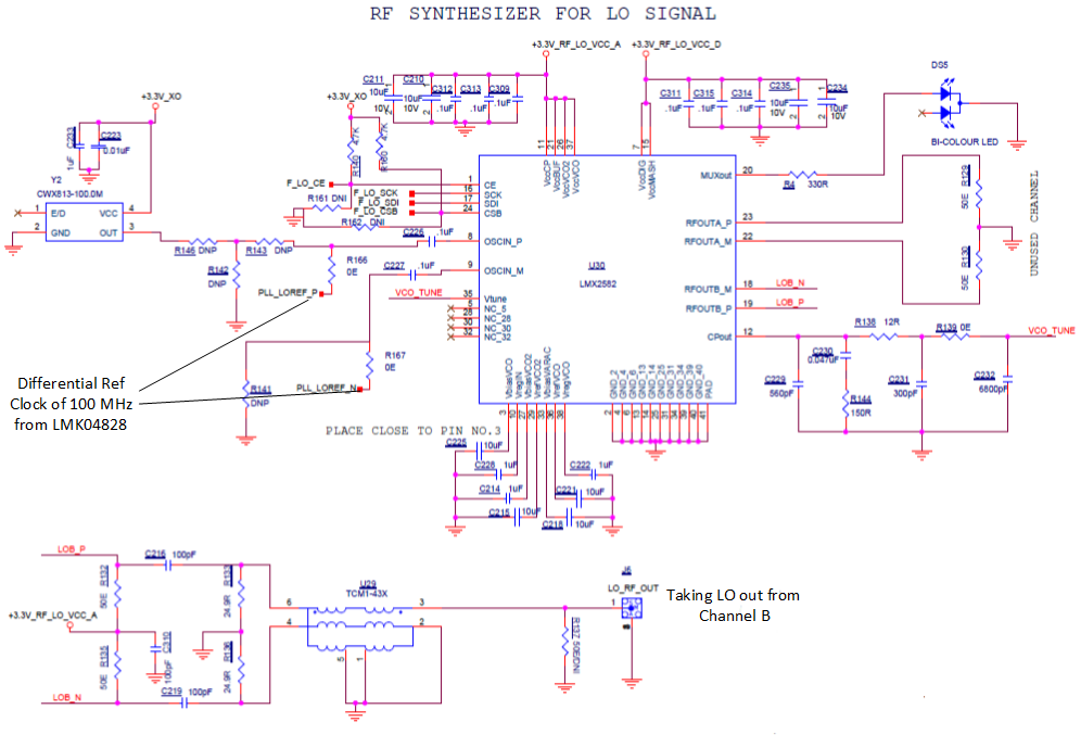

I have attached the schematic & test results for 1.2GHz.Please verify it.
I have terninated channel A & Taking output from Channel B only by converting differential out put of LMX2582 to single ended with the help of Balun TCM1-43X.
Test result @ for 1.2 GHz output:
TICS pro settings:
