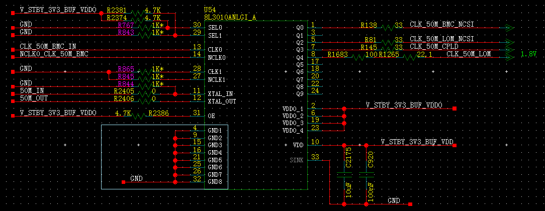

Can you help to review below schematic.
For the CDCLVC1310, can we connect all the GND pin together as below:
Lacey
Thanks a lot!
  • Hi Lacey,
    Some feedback:
    -The XTAL is not shown in the schematic, but it is selected with IN_SEL[1:0]. Place the XTAL close to XTAL_IN / XTAL_OUT.
    -Assumed that PRI_INP / PRI_INN input termination is OK.
    -Recommended to place 0.01uF and 0.001uF decoupling capacitors on each VDD and VDDOx pins near the device.
    -It seems that Q4 is being level translated to 1.8V. I assume this is OK. Be aware that impedance mismatches will degrade signal integrity. The other clock outputs are OK.
    -Connecting all the GND pins is OK.
