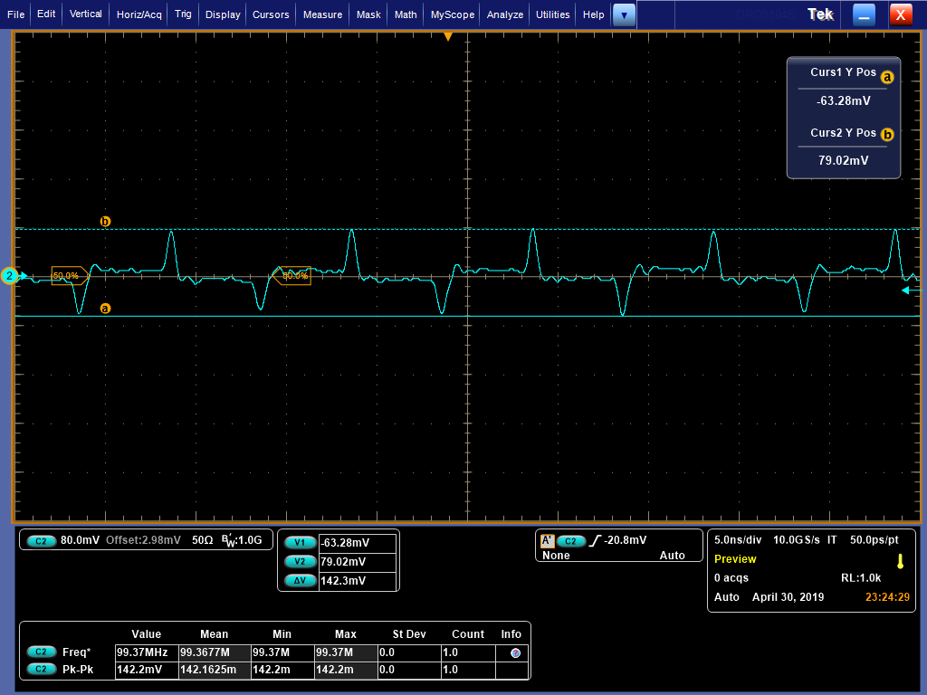

We use the CDCI6214 for Ref CLK of PCIe Gen3.

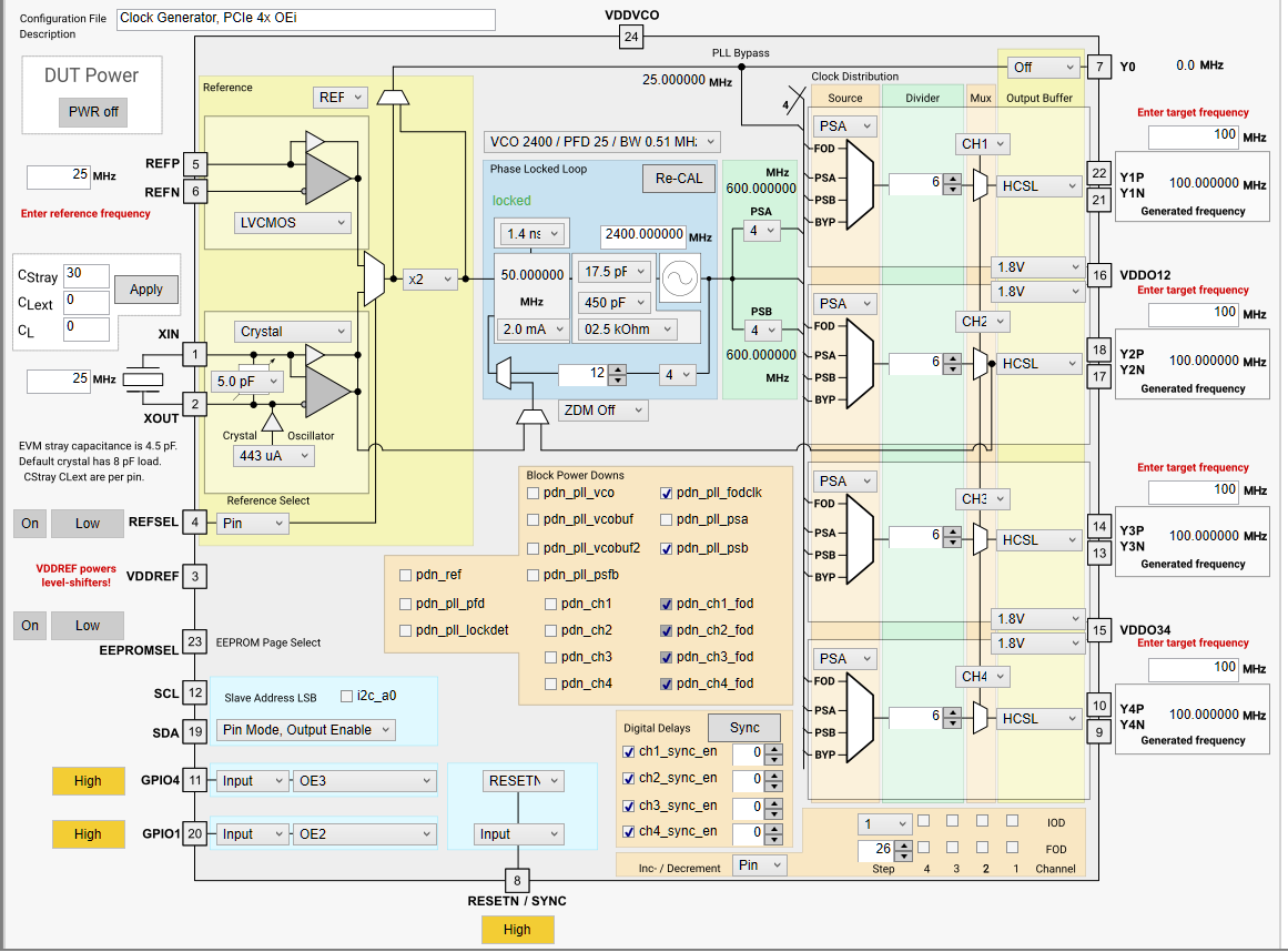

But we set it as HCSL in TICS PRO, channel 1-4  has erro different  clock output.  (Waveform see blow.)
(we set it as CML in TICS PRO, channel 1-4  has clock output.)
Please help me find where the HCSL problem .
Abel

    I assume you are working on the EVM.
    The default hardware configuration for Y1 and Y4 are not intended for HCSL output.
    You need to modify the board in order to support HCSL output. See Table 2-2 of the EVM user's guide for details.
