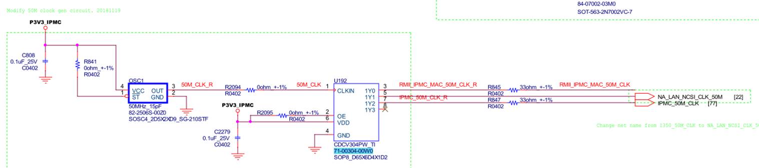

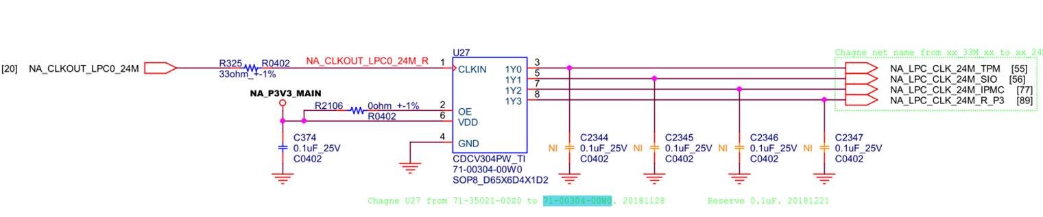

Part Number: CDCV304
Hi Team,
Please kindly help me double check below sch if good or bad.
Thanks a lot!
Andrew
1) One 24MHz input to four 24MHz output
(2) One 50MHz input to tree 50MHz output

Hello Andrew,
Your schematic looks good.
One suggestion with the output terminations, based on this post https://e2e.ti.com/support/clock-and-timing/f/48/p/193218/779650#pi320966=1, is using a 30-ohm series resistor for impedance matching with the 50Ohm transmission line.
