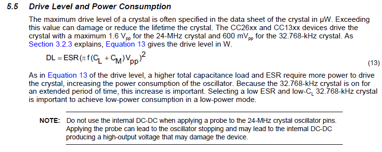

I am using Application report of
Crystal Oscillator and Crystal Selection for the CC26xx and CC13xx Family of Wireless MCUs by TI. In this report the formula for drive level is mentioned as shown in attachment below. Page 12
Freq = 2.4576MHz
ESR = 300
CL1 = 56pF
CL = 32pF
Cs = 5pF
VPP = 4.4V min    4.9V typ    and 5.9V max
by referring this we are getting our power level as
min - 0.2853 mW
Typ - 04262 mW and
max - 0.7326 mW
But the drive level formula shown in App note AN2867 Page 15
Using this formula we get drive levels as
min - 0.457 mW
Typ - 0.735 mW and
max - 1.279 mW
There is difference between two formulas one is considering only load capacitance value in formula i.e. from TI appnote and
from ST is considering only single capacitance value in formula.
So, need to understand why there is difference in formulaes and what should be considered.
