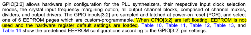

    Q3). Isn't GPIO[3:2] pins 4-state pin instead of 3-state pin ?
    I see following description in the LMK03328 datasheet, page 32.
    There is discrepancy between a) and b).
    a). GPIO[3:2] are purposed as 3-state pins (tied to VDD_DIG, GND, or VIM)
    b). When GPIO[3:2] are left floating, EEPROM is not used and the hardware register default settings are loaded.

  • 1) Yes
    2) I took a lab measurement and the GPIO2 and GPIO3 pins read ~0.9V when left floating. In the table above MID = floating = VIM (~0.9 V) regardless of whether you are trying to access page 1, page 4 or Register Default Mode.
    3) These pins are 3-state pins, high, mid (~0.9V/floating) and low. When GPIO[3:2] are left floating setting mid, mid is selected corresponding to register default mode.

    Sorry for the confusion. You must use external biasing on GPIO[3:2]. I notice this was answered in another post: e2e.ti.com/.../795641
    I will check with the design team for confirmation. I should get a response within a few days.

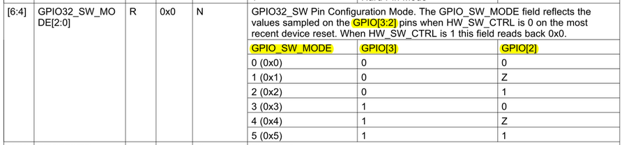

    [Datasheet describes to float GPIO[3:2] pin to use register default setting]
    [Datasheet page 59, GPIO[3:2] is described to set to VIM]
    [Datasheet page 85, R8 table shows "Z" for EEPROM page1 and page4 GPIO[2] pin setting, no register default setting shown]
    [User's Guide page 13, Table 3 shows "MID for EEPROM page1, page4 and register default]

  • I believe all the "?" should be "VIM (0.9V)".
    I configured the EVM to GPIO2 and GPIO3 floating, this implies 0.9V on the EVM because of the pull-up, pull-down resistor bias you pointed out. I then did a read-back onto TICSPro to see the settings listed for Register Default Mode.

    Regarding the datasheet description, many customer may be using GPIO2 and GPIO3 as floating (Hi-Z) on their board, over writing the registers which may be needed to be changed from the register default value. This might be the root cause that some customer is seeing unexpected behavior.
    There are several description to "float" the GPIO2 and GPIO3 pin for the device to start up with the register default value.
    Please make modification to this typo asap and it would be much better to describe each setting in the table such like above so that it is easy to understand.

  • GPIO [3:2] Summary
      GPIO3     GPIO2     Register Information (Soft Pin Mode)
       Low    Low   EEPROM Page 0
       Low    VIM*
      EEPROM Page 1
       Low    High   EEPROM Page 2
       High    Low   EEPROM Page 3
       High    VIM*
      EEPROM Page 4
       High    High   EEPROM Page 5
       VIM*
       VIM*
      Register Default
    * VIM = 0.9V(TYP)
