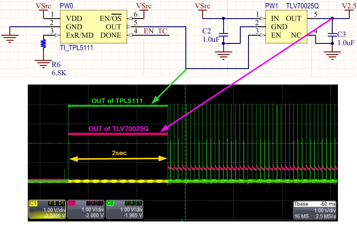

I used a TPL5111 as a very low power timer to enable a LDO, but it worked correctly once only for power reset. The output signal of it is in the following. Does anyone know what's wrong with my circuit? Thank you.

Hi Sunglin,
Do you have a scope shot showing the pulse on the DONE pin? Net name is EN TC in your schematic.
Are you using this as a watchdog timer or is it OK that the LDO will be shut down after 2 seconds?
