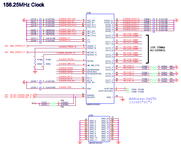

Hi Sirs,
Sorry to bother you.
Could you help review our LMK05318 schematic as below?
    1. It is recommended to use power supply filtering on the device supply pins. The LMK05318EVM User's Guide has the EVM schematic, see figure 10 for reference.
    2. PRIREF_N / SECREF_N can be left floating.

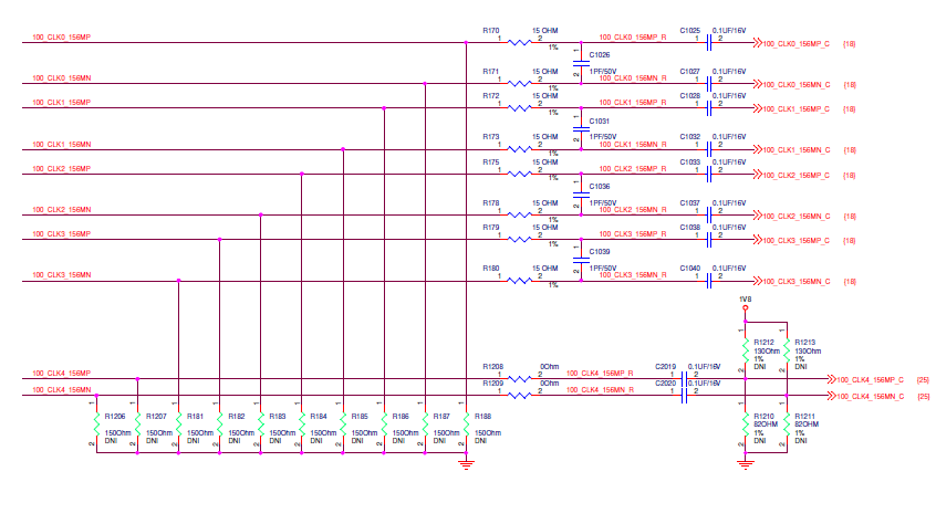

    3. The outputs should be terminated with an AC-coupling capacitor to 100ohm differential load. The 100ohm differntial load is not shown here. The 15ohms and 1pF are not required.
