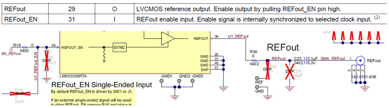

Hi Sir,
May I know the purpose for REFOUT and REFOUT_EN ?
Can floating or reserve to test point

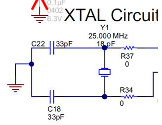

Hi Anne,
Sorry for the delay. The datasheet suggests 18-20pF XTAL load capacitance. I tested the default LMK00338EVM (where the XTAL circuit image was found), and it functions without issue.
