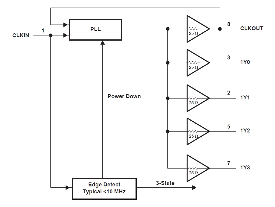

CDCVF2505: phase between input and output
Part Number: CDCVF2505
Can I use CLKOUT as a output like 1Y0 to 1Y3? What is the phase difference between CLKIN and 1Y0-1Y3?
Thanks.
  • You could use CLKOUT as an additional output. Propagation delay is given in table 7.7 and can be used to calculate phase.
    Note that the phase is adjustable by loading CLKOUT with a capacitor. See datasheet section 10.2.2 for more information.
