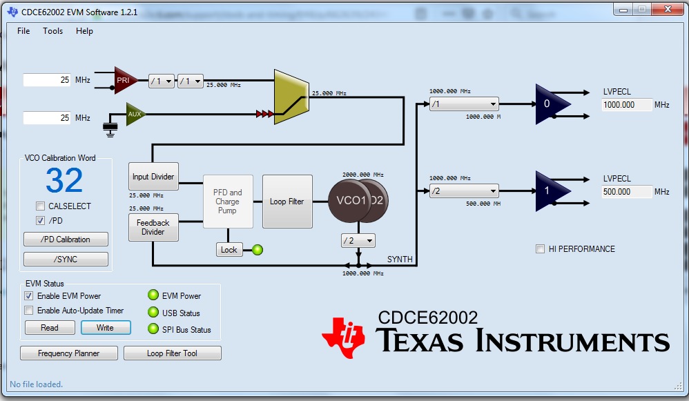

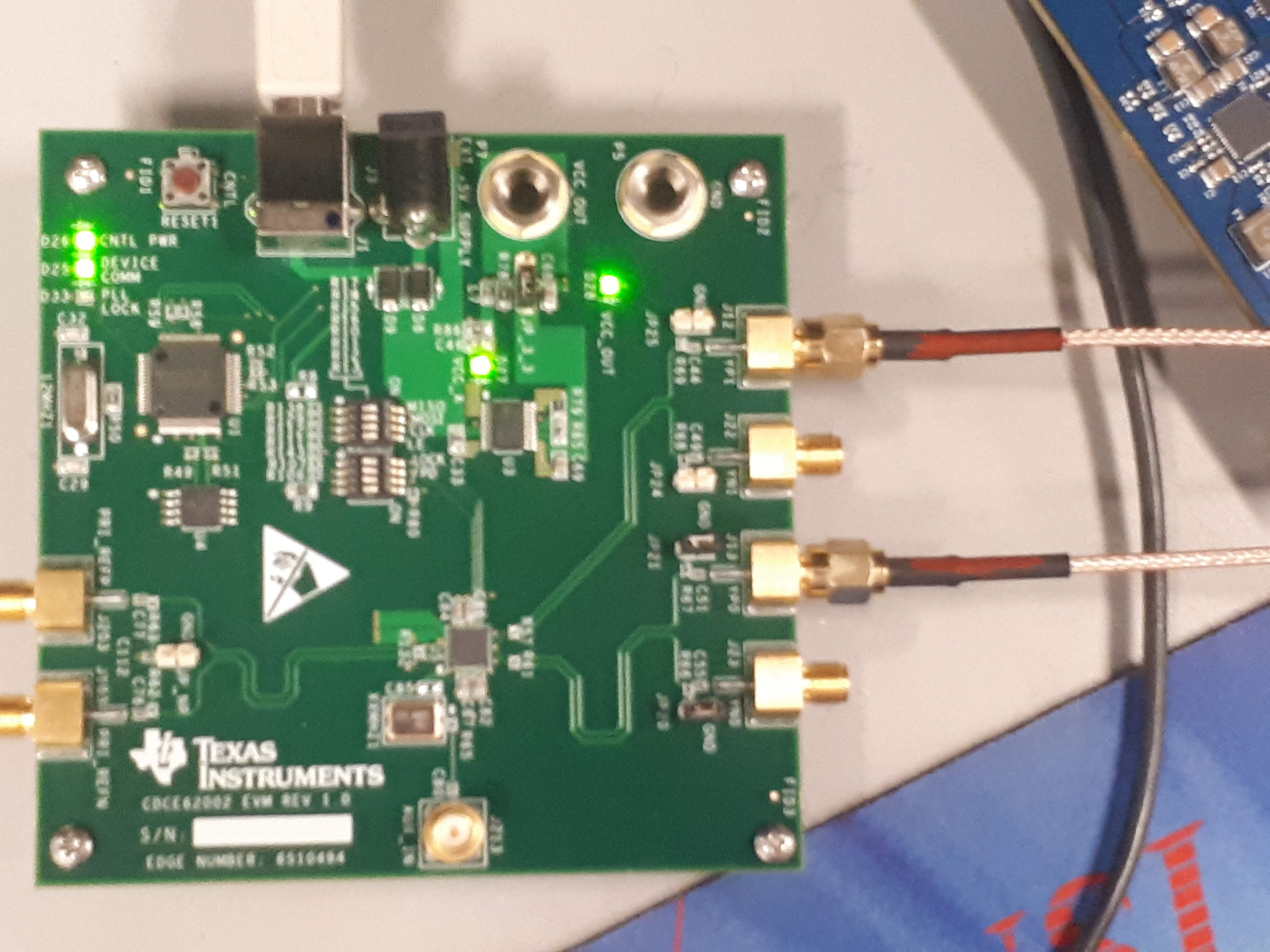

I have bought CDCE62002EVM recently and am trying to generate 1000MHz and 500MHz. I have used the Frequency Planner to setup the CDCE62002 GUI initially to generate these frequencies at the output ports. Even though I have been able to lock the PLL on the GUI software, I could not make the Eval board PLL locked, and the LED D33 on the Eval board is off.
CDCE62002 GUI Screenshot:
Eval board image:
Could you please let me know how I can work around the issue and lock the Eval board’s PLL?

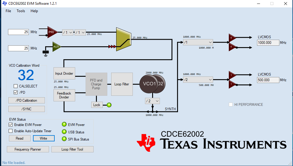

  • Hi Hao,
    As you suggested, I removed the JP21 Jumper, clicked "Sync" and "Calibration", changed the output format to LVCMOS, and write all registers. The board cannot lock even though the GUI green lock light is on.  I rest the board and go through the same process, but no luck.
    Eval board:
    I am wondering if upgrading the firmware can help. I appreciate for any advice on how to work around the locking issue.

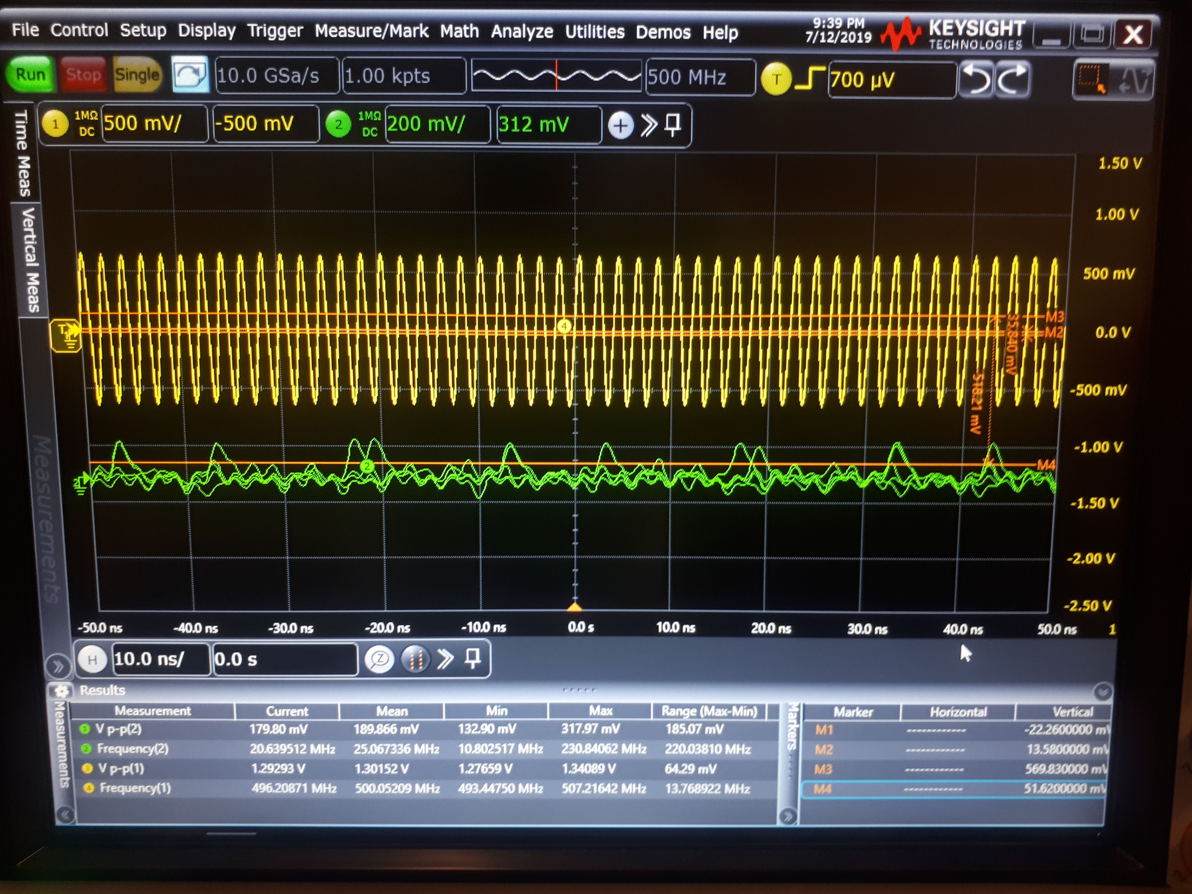

  • Hi Ed,
    What does your output look like? Is there no output at all or there is output but its frequency is not accurate? Could you attach a snapshot of your output?
    Hao
  • Hi Hao,
    The J12 port output signal is 500 MHz Sin wave with the 1.5Vp-p, but the J13 port output signal is a random one with the 40mVp-p. Please see the blow screenshot.
    Please kindly advise.
    Ed

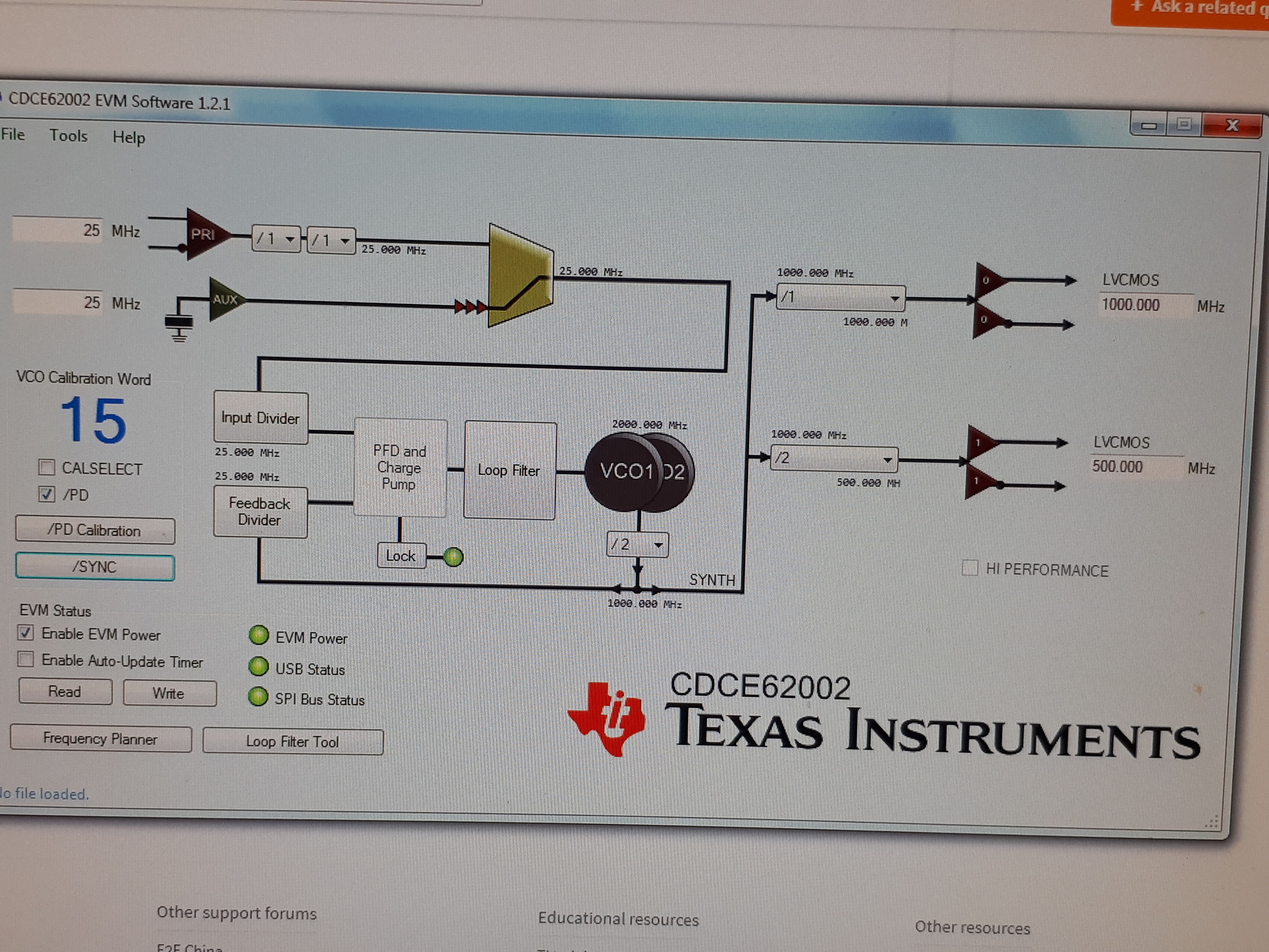

  • Hi Ed,
    Sorry for the delay, I was out of office. I'm attaching the screenshot of GUI and exported register:
    https://e2e.ti.com/cfs-file/__key/communityserver-discussions-components-files/48/CDCE62002_5F00_2019_5F00_07_5F00_08.ini
    I used default loop filter setting and turned off all 4 pins of SW9 and SW10 at the back of the board. Please try different output formats, with/without the jumper and so on.
    Hao
  • Hi Hao,
    I loaded your .ini file (File/open), turned off all four pins of SW9 and SW10 on the back of the Eval board, and write to all registers by clicking the Write button. The software GUI indicates the PFD and Gharge Pump is locked ( the GUI Lock LED is on), but the Eval board is not locked yet and the D33 Led is still off.
    For LVCMOS, The output for J12 and J22 is shows 1.4Vp-p 500MHz, but the J13 and J23 shows noise regardless jumpers are on or not.
    For LVDS and LVPECL, The output for J12 and J22 is shows 400 mVp-p 500MHz, but the J13 and J23 shows noise regardless jumpers are on or not.
    I appreciate for any advice on how to lock the Eval board.
    Ed

  • Hi Ed,
    I didn't light the D33 on the board either. I looked through the schematic but couldn't turn it on. However, looking at the scope and spectrum analyzer I see a stable tone without frequency drifting and I can tell that it's locked.
    For the 500MHz output that is working, can you change the output divider to 1 and see if you get anything? Same for the 1000MHz output, change the output divider to 2 and see if you get an output of 500MHz.
    Hao
