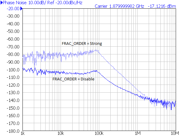

Hello!
I use LMX2591E as the LO of the down-conversion receiver, the frequency range is 1690MHz~1990MHz, step 0.25MHz, and the phase noise is abnormal in the range of 1879MHz~1881MHz. 1880MHz is typical as shown in the figure above, and the other frequencies are normal, I tried to change the wider loop but did not improve, the current Fpd is 100MHz and the loop bandwidth is 30KHz. I consulted the PDF and found that the frequency range of 1879MHz~1881MHz is the transition band between VCO direct output and bisection frequency. Is it a defect of the device itself or a problem of my configuration? Could you please help me to do the test?
