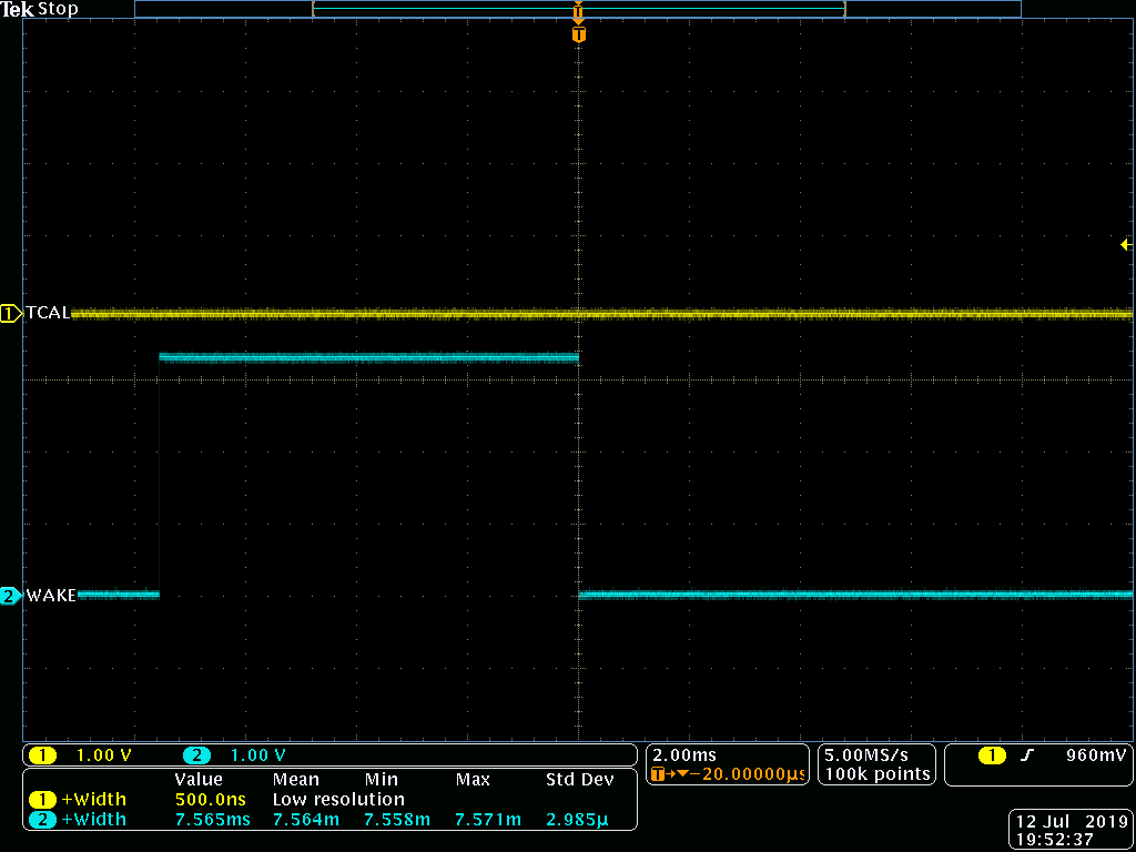

    Let me confirm some more.
    DONE connected to TCAL:
    In this case, the WAKE pulse width is around a half period of the internal oscillator?
    How much is the TCAL pulse width?
    It is almost zero and it looks like a just glitch noise because TCAL gets low as soon as TCAL gets high?

  • Hello Hirano-san,
    With DONE connected to TCAL:
    • The wake pulse width for my measurement was about 7.56ms.
    • The TCAL/DONE pulse is around 22ns.
