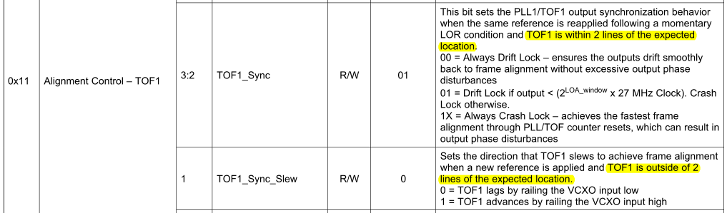

Please allow me to clarify about the LMH1983 TOF1 behavior. Could you please confirm whether my following recognition is correct ?
1). If the phase relation between TOF1 and FIN is inside 2 lines (+/- 2 Hsync window), LMH1983 will control VCXO input high or low whichever is closer for alignment. (REG 0x11 [3:2] setting is ignored.)
2). If the phase relation between TOF1 and FIN is outside 2 lines (+/- 2 Hsync window), Drift lock always controls the VCXO input voltage based on the REG 0x11 [1] setting to achieve frame alignment.

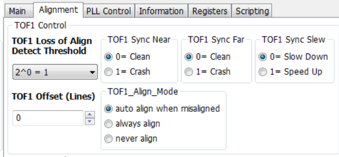

  • Hello Hao-san,
    Based on my test, I can see the device advances or delays VCXO frequency when forced to drift lock mode and the phase difference is inside +/- 2H period.
    When the phase difference is inside +/- 2H period, the device does not follow REG 0x11 [1] setting and seems it is achieving fastest frame alignment.
    Is this behavior intended for design ? It seems like the device is having a smart logic in this condition.
    Could there be a bug in the GUI I used, which is Analog Launch PAD that the setting would not be correctly applied ?
    I believe you could see the same symptom with your LMH1983EVM.
    I had selected both TOF1 Sync Near/Far to drift lock (clean), then disconnected (Free-Run at certain control voltage) and connected (GenLock) the analog reference input.
    Here I've selected TOF1 Sync Slew = Slow Down, however, we observed VCXO frequency speeding up for alignment.
    Kawai

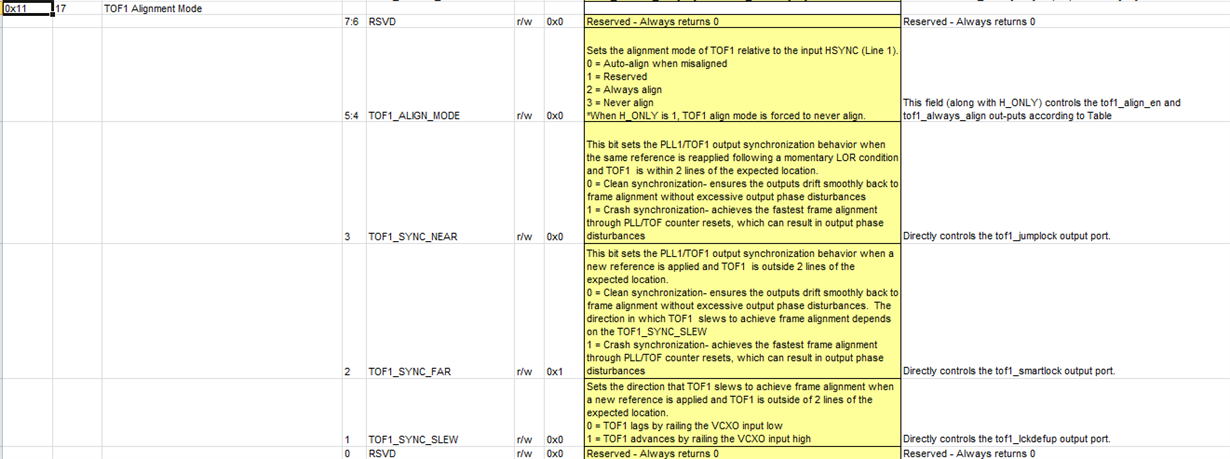

  • Hi Kawai-san,

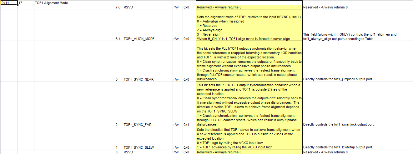

     I can help locate some information. Here's the description I found for 0x11:
    Hao
  • Hi Hao-san,
    I understood your situation. However, if that is the case, who should we ask for this question ?
    My recognition is that "TOF1_SYNC_SLEW" sets the direction either to increase or decrease the VCXO frequency (control voltage) to align the input and output frame. However, what we see is that this setting is not working when the phase difference is under 2H period. It seems that the device is smart choosing the direction which phase difference is smaller, which would be better for users, but, only smart at under 2H period.
    Can we say that LMH1983 always behaves this way ?

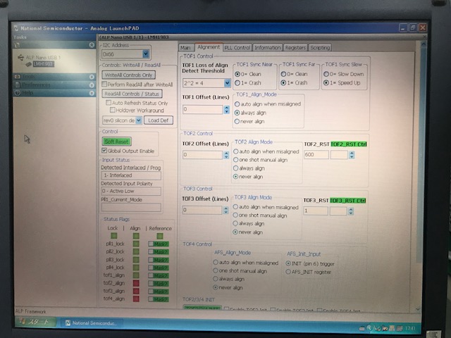

  • Hi Liam-san, Lane-san,
    We have request to clarify this behavior if this is correct or not from the device design side. So, please allow me to close the post when this is confirmed.
    LMH1983EVM is operated as following setting (REG 0x11=0x26 or 0x24) with TOF1 enabled (REG 0x0A[0]=1).
    Input video format is NTSC (480i/29.97). I believe input video format does not matter.
    With the above setting, please monitor HIN, FIN, and TOF1 waveform and try disconnet and connect (re-apply) the input video. You could see the device tries to align TOF1 to FIN/HIN to same direction even if you change the TOF1 Sync Slew setting. it seems the Sync Slew setting is ignored. Could you please check ?
    If Sync near and Sync far are both set as "Clean", Sync slew setting seems to be acting correctly.
    Kawai
