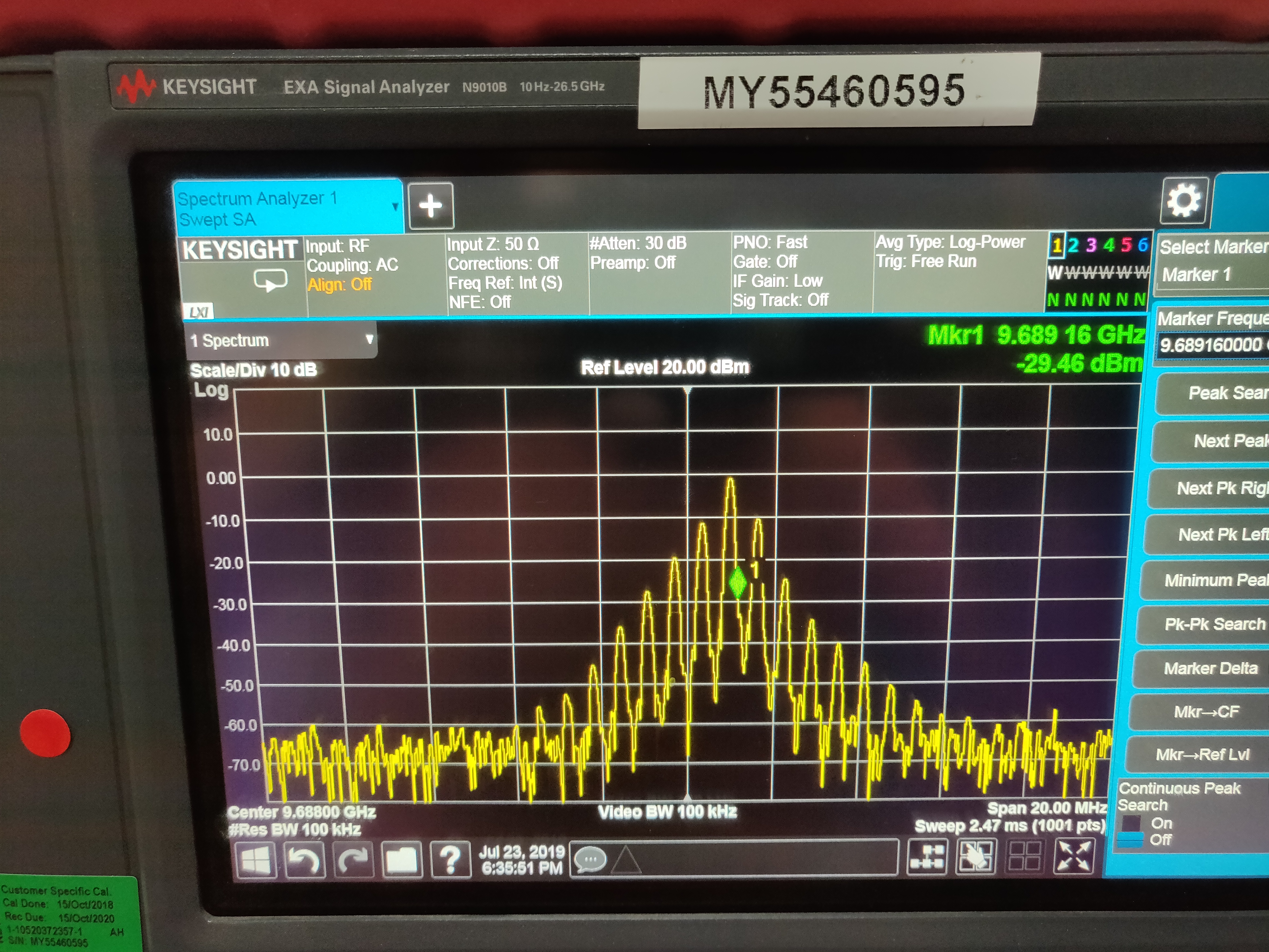

i'm currently testing the LMX2594 by using its evaluation board, I have tested few freqs at different temperatures.
i found that a specific freq 9.75 GHz not locks at 85 deg inside the oven while other higher freqs are ok at this temp for e.g. 11GHz or 13GHz
when i reduce the temperature to 80 deg the synt locks again on the desired freq of 9.75 GHz. but again unlocks when increase the oven temperature to 85 deg
i use 100MHz OCXO at synt input , 0.1uF DC block & 50 Ohm match for single ended input of 9dBm which is less that 2Vpp as in synt spec.
what could be the reason that it stops to operate at 85 deg in specific freq, see the attached synt configuration picture and the signal on Spectrum
isn't it suppsoe to operate till 85 deg temperature? is it so near its limits?
