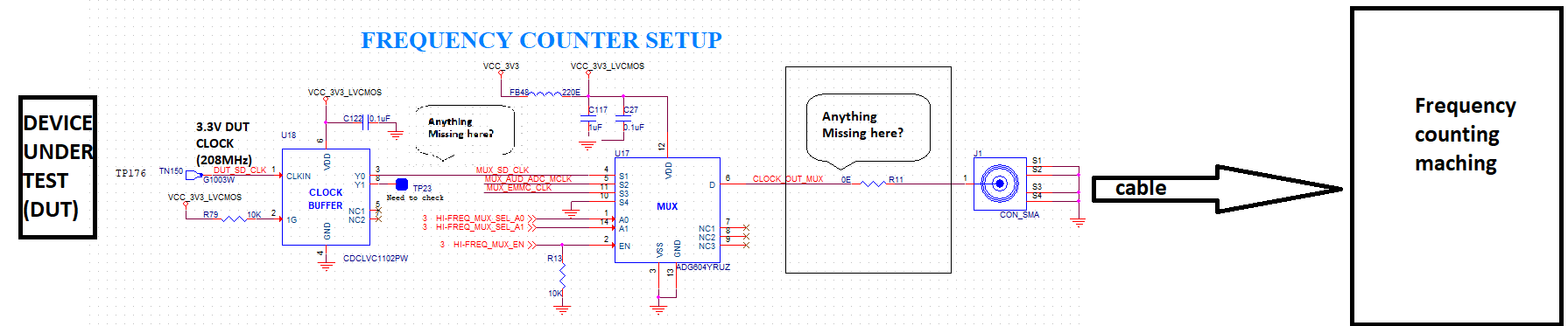

Hi
We are designing a PTS(Product testing System) where some High frequency 208MHz clock is used in DUT device and here we have to check its frequency through some POGO pins, then came to our board then go through cable connector to frequency counting machine to show its frequency. So our question is, What configuration we required before going into Connector. We are sharing one snap of our circuit, so please let us know if any protection or impedance matching ckt needs here.
