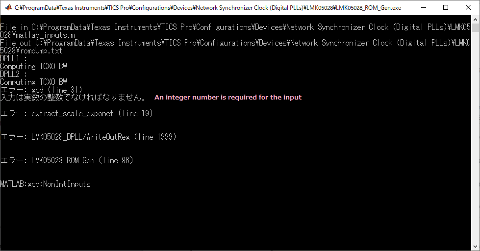

Suddenly, I and the customer TICS Pro have error when we try to run the script. Our TICS Pro didn't have the error a few days ago... Do you know what is the cause? エラー means error

1, My version is 1.6.10
2, I tried it, but there is an error.
3, Please refer the following post "e2e.ti.com/.../3053793
Satoshi Yone
Hi Satoshi,
I found only "2 loop: TCXO, APLL" would make matlab run error, other modes are good.
Before we fixed this error, please adopt "3 loop:REF,TCXO,APLL" mode. TI US team would looking into it when they are back.
W/o REF input, you still can achieve 2 loop DCO control.
Shawn

The issue also occur which you shared last time. I don't know why.... The issue suddenly occur on my PC and the customer PC.

I confirmed this error. It will be eliminated in the update. Also, it would not appear if loop bandwidth for TCXO is < 5 Hz. (Which is currently set by REF loop bandwidth). This will be updated also.
