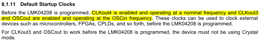

LMK04208: Default CLKOUT3, CLKOUT4, and OSCOUT output clock before register programming.
Guru 19785 points
Part Number: LMK04208
Hello Team,
Please allow me to clarify the following description in the datasheet.
Before LMK04208 register is programmed, based on the default register settings, I believe CLKOUT3, CLKOUT4, and OSCOUT operates as followings. Am I understanding correctly ?
- CLKOUT3 = External VCXO Frequency
- CLKOUT4 = Internal VCO Frequency / 25
- OSCOUT = External VCXO Frequency
If not, please tell us each correct output frequency.
