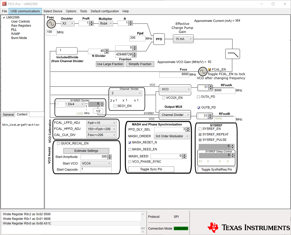

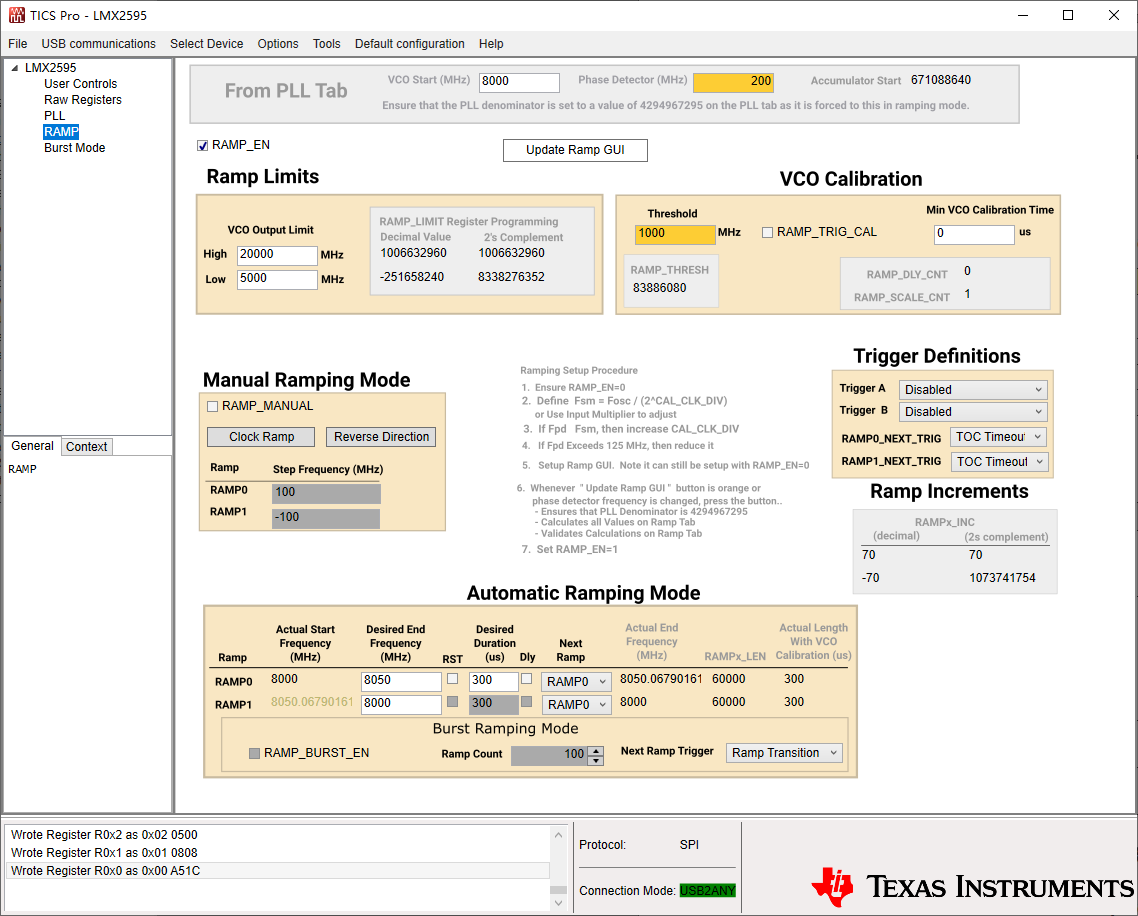

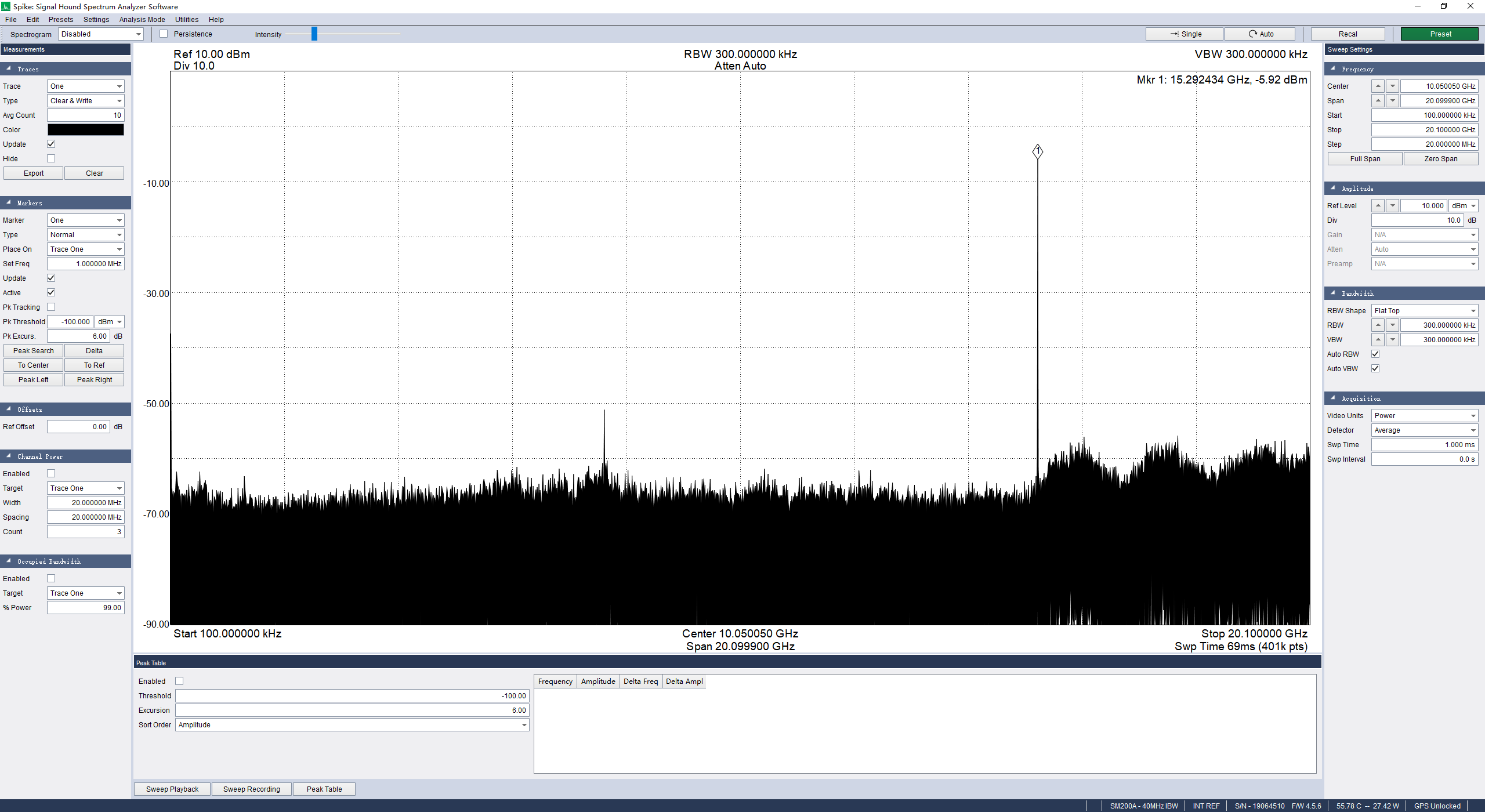

I want to generate chirp signal 8G-0.05G.
TICS PRO was set as below:
then i got the wrong speccturm as below:
what should i do?
