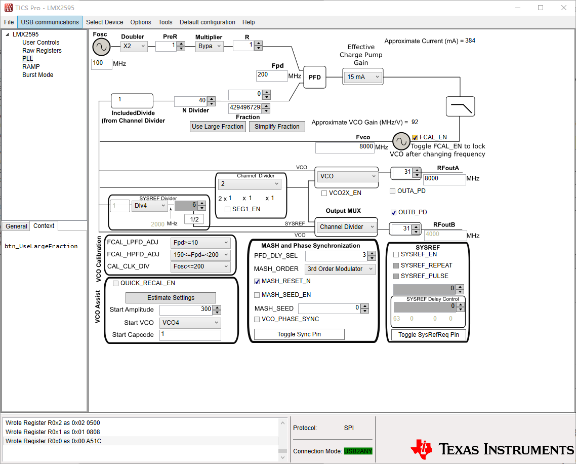

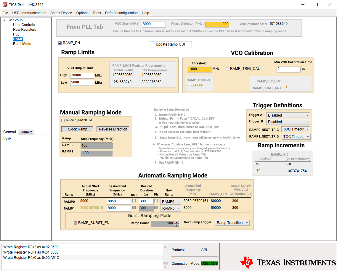

One customer  use the LMX2595 to generate the incremental LFM signal which range is  8G ~8.05G. The configuration is as following with TICSpro:

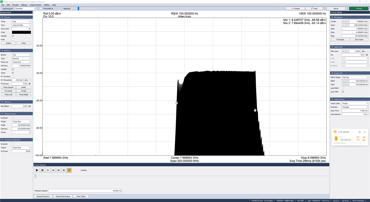

The output is not correctly, please refer to the output:

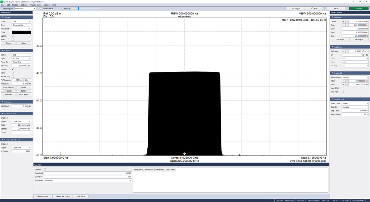

But when changed the next_ramp of RAMP0 with RAMP1, the output is normal, please for your reference:
