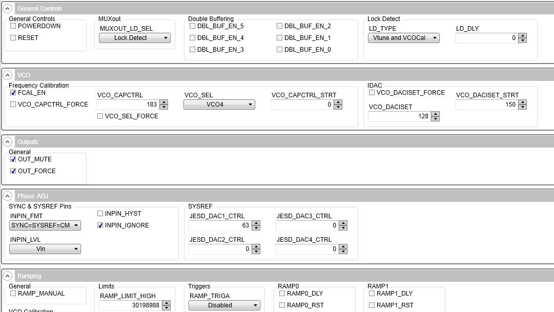

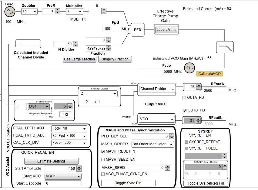

I am using LMX2572 for sweeping frequency from 2500 MHz to 2590 MHz. For that Iam using divide by 2 at output which is converting VCO frequency from 5000 MHz to 5180 MHz.

The above configuration I am using. However I am getting a fixed end frequency i.e. 2590 MHz. I am not getting a sweep pattern. Is my settings OK?
