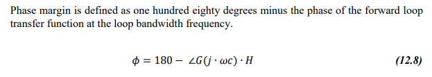

There is following description in LMK04803 datasheet page 115.
When I simulated design and phase noise using WEBENCH Clock Architect, the design was not following this guideline.
I believe there are many cases that could not meet the above recommendation.
Does the device still operate normally when not meeting this condition, besides having the longer lock time ?

  • Hi Kawai-san,
    Q1) If the phase margin is large enough to be stable (>45° generally), it is acceptable to choose other loop bandwidth and phase detector values. Changing the phase detector frequency and loop bandwidth will affect the phase noise, so keep this in mind when making changes.
    Q2) The integrated loop filter components for the LMK04803 restrict the allowable values for R3/R4/C3/C4. The maximum achievable bandwidth I could find was about 215 kHz, which should be fine (phase margin of about 68°).

    Using the below filter value, I can read that there is over 60 degrees phase margin.
    However, I have one question.
    How can you read this from the bode plot graph ?
    I thought you would read the phase margin at the point where closed loop gain is 0dB.
    Kawai
  • Hi Kawai-san,
    From the PLL Performance, Simulation, and Design textbook:
    The loop bandwidth frequency is defined as the location where the loop gain is attenuated by half (about 3dB).
  • Hi Derek-san,
    I understood. Thanks for your kind support.
