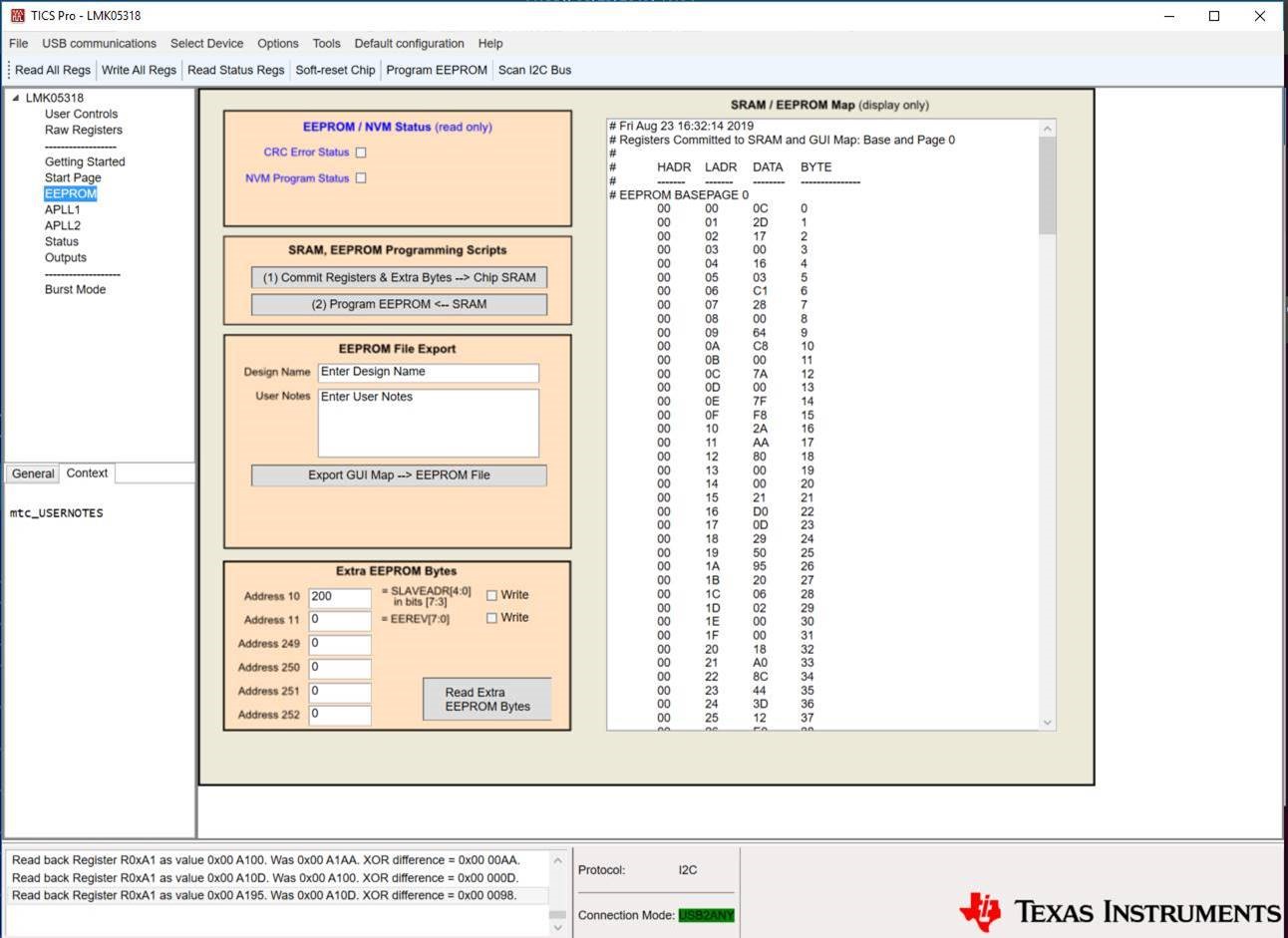

       1)  And we tried to dump the content of EEPROM of LMK05318 on ARM CPU +Linux OS.
        But 6 bytes of EEPROM (dumped on ARM CPU + Linux OS) are different from
        the "SRAM/EEPROM Map" of TICS Pro.
       1-1) The "SRAM/EEPROM Map" of TICS Pro
        1-1-1) Click "File" menu, click "Load" sub-menu to load the *.tcs file.
                  Then, click the "EEPROM" entry to view the "SRAM/EEPROM Map" of LMK05318.
       1-2) The 6 bytes are different, but the other bytes are same with the TICS Pro.
       1-2-1) The 6 bytes (different)
       1-2-1-1) The 2nd-byte : TICS Pro=0x2D, our application= 0x18
        1-2-1-2) The 3rd-byte : TICS Pro=0x17, our application= 0x2B
        1-2-1-3) The 5th-byte : TICS Pro=0x16, our application= 0x31
        1-2-1-4) The 6th-byte : TICS Pro=0x03, our application= 0x16
        1-2-1-5) The 8th-byte : TICS Pro=0x28, our application= 0x20
        1-2-1-6) The 9th-byte : TICS Pro=0x00, our application= 0x8B
        Could you tell us your comment?

  • Hello Hank,
    Address 0 to address 9 of EEPROM are actually read only EEPROM bytes.  So they can be different from your device to tics pro.  TICS Pro won't be able to overwrite them and you wouldn't need to worry about their values.
    73,
    Timothy
  • Dear Timothy:
       We compared the whole content of the internal EEPROM of LMK05318 (read on R161)  with the SRAM/EEPROM Map displayed by TICS Pro.
      1) And we found that 2 more bytes are different.
       1-1) The 38th-byte of EEPROM:
            Read by R161:  0x12
            SRAM/EEPROM Map displayed by TICS Pro : 0x01
       1-2) The 39th-byte of EEPROM:
            Read by R161:  0xE0
            SRAM/EEPROM Map displayed by TICS Pro : 0x40
      Could you tell us your comment about the 2-byte of EEPROM?
      Thank you.
    Best Regards.
  • Hello Hank,
    The 38th byte is address 37.... below is the info.  Is it possible that the status outputs got updated between writing to EEPROM and readback of EEPROM?
    Address Bit 7 Bit 6 Bit 5 Bit 4 Bit 3 Bit 2 Bit 1 Bit 0
    Adr 37 STAT0_SEL[3] STAT0_SEL[2] STAT0_SEL[1] STAT0_SEL[0] STAT1_SEL[6] STAT1_SEL[5] STAT1_SEL[4] STAT1_SEL[3]
    Adr 38 STAT1_SEL[2] STAT1_SEL[1] STAT1_SEL[0] GPIO_FDEV_EN CH7_PD CH6_PD CH5_PD CH4_PD
    73,
    Timothy
