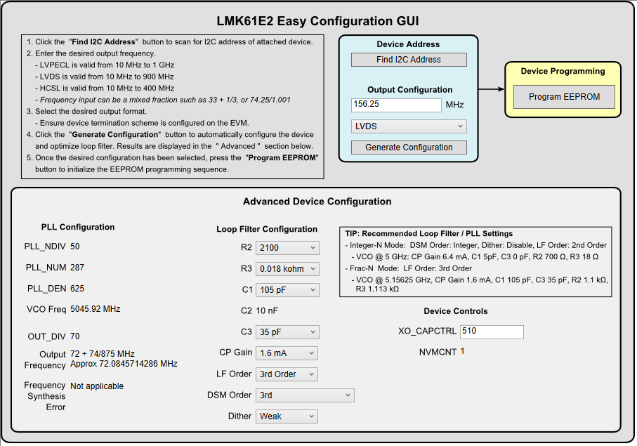

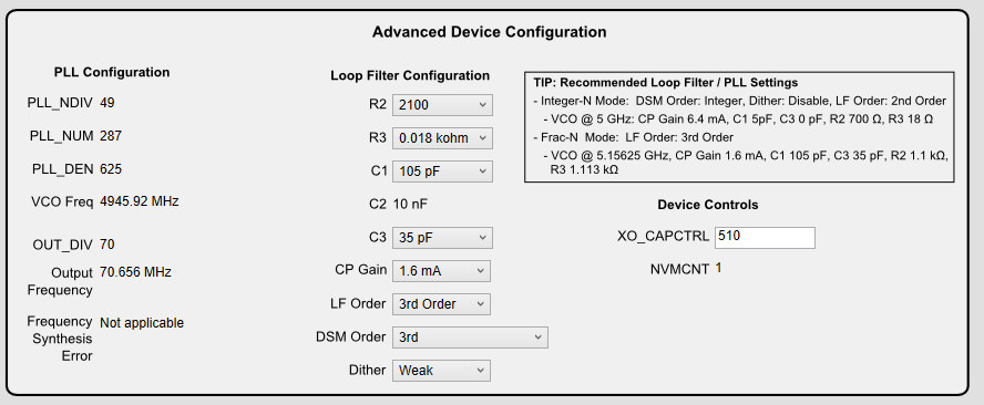

    Sorry for the late response. The GUI for LMK61xx families can be very convenient even if you don't have a USB2ANY, because it provides register information and can help you better understand the device. (http://www.ti.com/product/LMK61E2)
    One possible reason you didn't get the correct frequency was that you didn't toggle R72[1] after changing registers. This bit is used to initiate VCO calibration. To help you systematically understand what's going on inside, let's start from the beginning.
    The internal crystal frequency is 50MHz. If you use input doubler (which is used by default), you get 100MHz at Phase Frequency Detector. The VCO frequency can be back-calculated using VCO = 100MHz * (PLL_NDIV + PLL_NUM/PLL_DEN).
    Now, to give you an example, the default setting with 70.656MHz output looks like this:
    If I change the PLL_NDIV from 49 to 50, then toggle R72[1], I get this:
    I verified that the output frequency is correct.
    I'm attaching the register files for both examples:

  • Hello Pawel,
    If you use I2C to communicate to the device all the time, then you need to toggle that bit to initiate VCO re-calibration every time you change frequency, because VCO does not calibrate automatically after a change.
    There is indeed a VCO calibration at powerup, and that's why you see the initial frequency upon powerup. In order for it to change the initial frequency upon powerup, you need to write to EEPROM. To do so, you may want to use TI GUI via USB2ANY because writing to EERPOM is a complicated process.
    I'm not sure what you'd want to set NUM/DIV > 1, because the total divider value = NDIV + NUM/DIV. For example, if you want to divide by (25 + 4/3), then you can do (26 + 1/3) instead. The case where NUM/DIV >1 is never expected.
    I believe I already explained the formula for frequency calculation. I'll attach once more: VCO = 100MHz * (PLL_NDIV + PLL_NUM/PLL_DEN).
    output frequency is simply VCO/output divider. Just make sure that VCO operates in the range specified by datasheet.
    Hao
