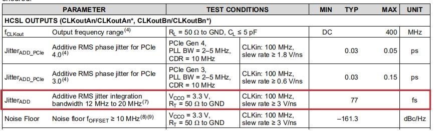

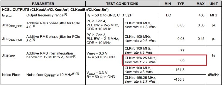

TI's LMK00334 material, there are two kinds of datasheets in Chinese and English. The two parameters are different for the Jitter-add parameter description:
     The Chinese version is as follows, only the Jitter-add data with CLKin at 100MHz is given:
     The English version is as follows, CLKin is 100MHz and 156.25MHz Jitter-add data are:
     Can you help me to confirm, which one of the two materials is subject to LMK00334 can support 156.25MHz application, when the Clockin is 156.25MHz, what is Jitter-add?
