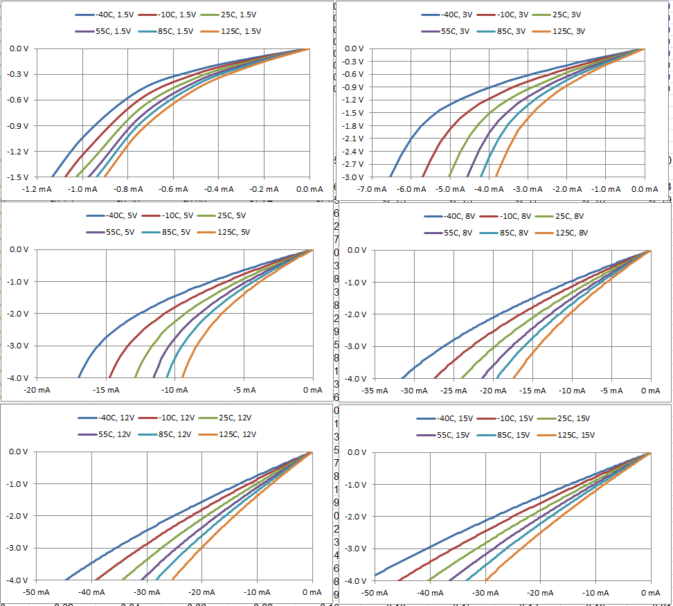

do we have the data which shows the relationship data between "voltage drop of Vcc-Voh" and Ioh?
Customer has concerned "how much IoH is bigger" impacts on voltage drop.
they want to know how much are there.
could you give us ?
