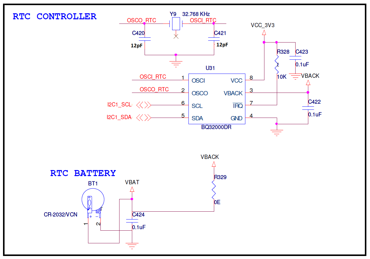

In Mentioned RTC Controller found one timing issue, When after set the date and time if reboot or restart the board,the timing is getting 1sec delay for each reboot or restart.
Example : setting time 17:15:00 thu 19:09:2019 after 15 restart or reboot, the time will be 17:00 thu 19:09:2019
in normal condition(in running state) its working properly.
