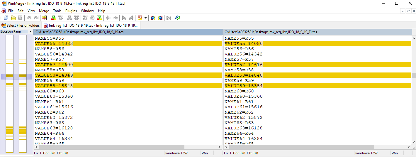

    I didn't see any sign of spur at 400kHz. I assume that you are not using TI EVM, so please check if there's any external 400kHz on your board. I adjusted some registers to improve device performance: lmk_reg_list_IDO_18_9_19_TI.tcs

  • It's been a few days and I don't remember exactly what I changed. But I probably changed quite a few. You can compare the two .tcs files in Winmerge. (Check which registers are different and find those registers in Ticspro or datasheet)

    Just to be clear, there are three versions of configuration. The original version that you sent me doesn't produce a 400kHz spur (it generates other spurs though). The "clk_config_012319_LB_from_TI" that you just sent does contain the 400kHz spur. And the version that I sent you optimized the loop filter settings and so on. In general, the reason why there's a 400kHz spur is that the PLL fractional order was set to 1st order when it's supposed to be 3rd order. The theory behind this a little complicated to explain but you can refer to some PLL literature such as Dean Banerjee's PLL book if you are interested.
    In general, instead of trying to figure out the PLL setting yourself, use the Wizard page for frequency planning. It's been tested and is quite reliable. That's actually what I did to generate that profile. Download the latest version of Ticspro if you don't see that page. When there are multiple options, choose the one that has the highest "score".
