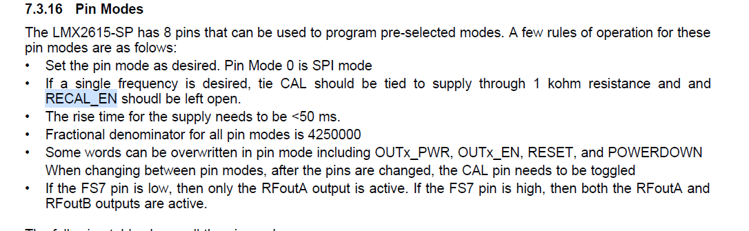

The RECAL feature helps mitigate the scenario when the VCO is in lock but loses lock when radiation event occurs.
Currently in our breadboard (same as TI Eval board), wehave it pulled down low. I know it is internally pulled up high to VCC with 200 kohms.
 Does this mean that the RECAL_EN feature is enabled based on the TI Eval board/breadboard schematic?
 If it not enabled, Do we need to have a pull up resistor?
