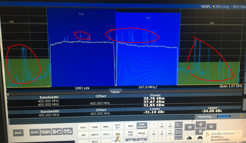

      The spur picture is as follows.the blue is maxhold trace,the yellow is average trace.As the accumulation of time,the spur on the blue trace will be more and more,i didn't do anything just let the time go.Is this will be produced by the vco calibration?
    many thanks!

    I don't understand the plot, what was you measuring and what did you do to the PLL?

     3.for the plot,i use lmx2594 as LO singal,which mix the IF singal from DAC through the mixer.the wide signal is produced by the fpga. What i measure is the output of my board.the chain is like this:fpga->dac->filter->mixer->filter->amplifier->output.when i see the signal is normally output i do nothing to the PLL,I just monitor the output for a long time to see whether is stable or not.

    3. If the PLL is locked, it will not generate random-moving spurs. Can you measure the output of LMX to confirm?

    3.the spur I have already confirm that it is not from lmx2594 on my board.
