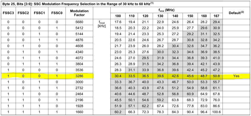

CDCE706 has a SSC modulation frequency selection function, however, CDCE913 does not.
Based on the "SSC Modulation Frequency Selection" table in the CDCE706, I believe, CDCE913 is like fixed to one of the setting.
Customer has a request for "fvco vs fmod table" for CDCE913, fvco range from 80MHz to 230MHz.
Could you please provide us the information something similar like the following ?
* Above is the default setting for CDCE706.
[CDCE706 Datasheet page 20]
