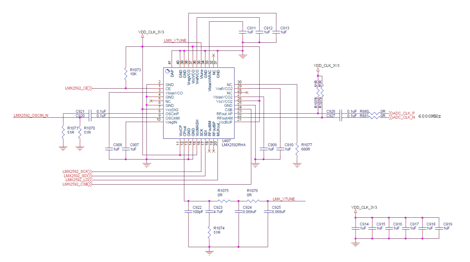

Dears.
The LM2592 is designed and tested.
Please review our issue.
I changed the frequency by unlocking at 6Ghz.
When it is changed to 400MHz step, it locks up to 4.8GHz.
From 6.8GHz, it is locked again.
I tried modifying the bypass cap and loopfilter but the symptoms are the same.

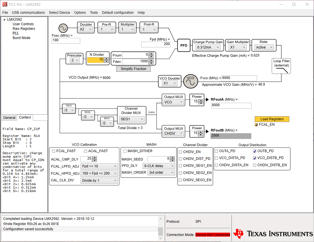

Below is the value controlled through the GUI
Register Set Value
R64 0x400077
R62 0x3E0000
R61 0x3D0001
R59 0x3B0000
R48 0x3003FC
R47 0x2F08CF
R46 0x2E0FA3
R45 0x2D0000
R44 0x2C0000
R43 0x2B0000
R42 0x2A0000
R41 0x2903E8
R40 0x280000
R39 0x278204
R38 0x26001E
R37 0x254000
R36 0x240011
R35 0x23021D
R34 0x22C3CA
R33 0x212A0A
R32 0x20210A
R31 0x1F0401
R30 0x1E0034
R29 0x1D0084
R28 0x1C2924
R25 0x190000
R24 0x180509
R23 0x178842
R22 0x162300
R20 0x14012C
R19 0x130965
R14 0x0E0108
R13 0x0D4000
R12 0x0C7001
R11 0x0B0018
R10 0x0A10D8
R9 0x090B02
R8 0x081084
R7 0x0728B2
R4 0x041943
R2 0x020500
R1 0x010808
R0 0x00231C

  • HI Henry,
    How did you change the output freq? Did you program R0 every time you change the freq?
    From your screen shot, the N-divider box turned yellow. You can mouse-over the box to see suggestion.
    In this case, N-divider is too small for a 3rd order MASH_ORDER. You should either reduce the fpd frequency or use Integer MASH_ORDER.
