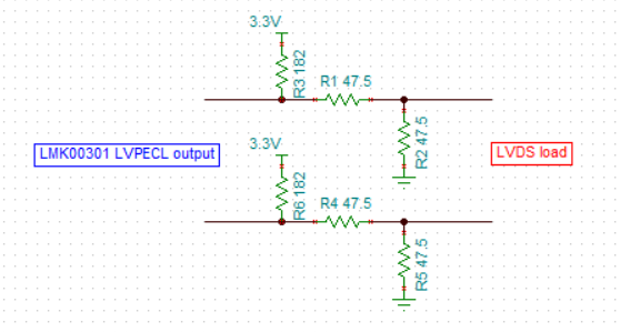

4. customer use below circuit for convert LVPECL output to LVDS to the load,  pls help comment whether it is ok. tks!

    A4. Does the receiver have integrated terminations? Does the reciever have integrated biasing? This will impact the termination network.
    The 182ohm resistors and 47.5ohm series resistor should be placed close to the driver. Use AC-coupling at the receiver before receiver terminations. If there is no integrated receiver termination, replace the 47.5ohm parallel terminations with a 100ohm differential load. If there is an integrated receiver termination, the customer can DNP the 47.5ohm parallel terminations. If the receiver does not have integrated bias, you will need to generate a bias at the receiver using kilohm resistors.
